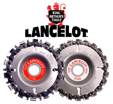

Hi guys , i have a chainsaw like this :
but i noticed that the impedance between his power cord when i push ON is 14 ohms ! so i want to know if this low resistance is normal or can be dangerous . i dont test it yet
Ya’akov
Joined Jan 27, 2019
10,235
That's not a chainsaw, it's an angle grinder. You are measuring resistance not impedance. They are both measured in ohms, but one is DC and the other AC.
14Ω is a totally normal resistance for a motor like that.

You have posted a picture of an angle grinder but you are asking about a chain saw. You give no information on the voltage and power rating so we can not check a tool with a similar rating motor. (Ideally you should compare it with another of the same model.) Series wound (Universal) motors do tend to have quite a low resistance. If it is quite a high power motor then 14 ohms is not unreasonable particularly if your mains voltage is 110 volts.

Ok , i dont know what is the name of this machine , but google traduction say chain saw .
Voltage : 220 ac
Power 1010 watts .
Thanks

I have just measured the resistance of one of my small angle grinders. It is rated at 900 Watts 230 volts. It's resistance is 11 ohms. I am pretty sure that the 14 ohms that you measured is OK. If you bought your angle grinder thinking it was a chain saw DO NOT try to use it for cutting trees.
