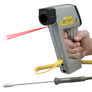

Hi
Could anyone suggest a Pyrometer (Remote temperature measuring device, capable of measuring above 350 Degree Celsius) with embedded humidity meter also.
I need a pyrometer for my project and thinking of buying a product which can also measure humidity and may be ambient temperature also.
if anyone knows product with this combination please suggest me.
Thanks.

My Requirement is just remote temperature measuring product. let's say i have a laser gun which can measure temperature by pointing it at hot surface to be measured. But i don't want to measure the humidity of that hot surface. i can use it to measure humidity when it is not been used for temperature measurement. i just asked a product with this added feature.
How do you plan to use a laser for humidity measurement?

How do you measure temperature with laser? The radiation from a hot object is very non-laser like.
Are you sure the laser you see is not just to show approximately where the IR detector is pointed?

I think you could use spectroscopy to measure the density of water vapor and air separately but you'd probably need a mirror on your target to reflect your beams. I'm not aware of any such instrument.
I agree the laser is more likely a targeting aid than anything to do with the measurement.

Laser is a spectrum which is just a near Infrared spectrum..and which is transmitted from the infrared gun and reflected back from the object. this reflected waves detected by IR detector and so it measures temperature from this reflected radiation.

The device has a visible laser which is only used to point the device at the desired measurement spot, it has NOTHING to do with the temperature measurement.
It actually measures "black body" IR radiation from the target, very long IR wavelengths.

I think you have a serious misunderstanding of how you pyrometer works. Here is the briefest description from Wikipedia:
An infrared thermometer is a thermometer which infers temperature from a portion of the thermal radiation sometimes called blackbody radiation emitted by the object being measured. They are sometimes called laser thermometers if a laser is used to help aim the thermometer...
Your pyrometer does not measure a reflected laser beam. It detects the infrared emitted by the object it is pointed at.

As several of us have said, you are wrong about your pyrometer using laser emissions to determine the temperature of the object at which it is pointed. The laser on that instrument is nothing more than a visible pointer. The infrared light that is emitted from an object, which is proportional to its temperature, is not laser light. It is emitted in all directions. That pyrometer detects that light. Have you read and understood that Wikipedia link on black-body radiation?
