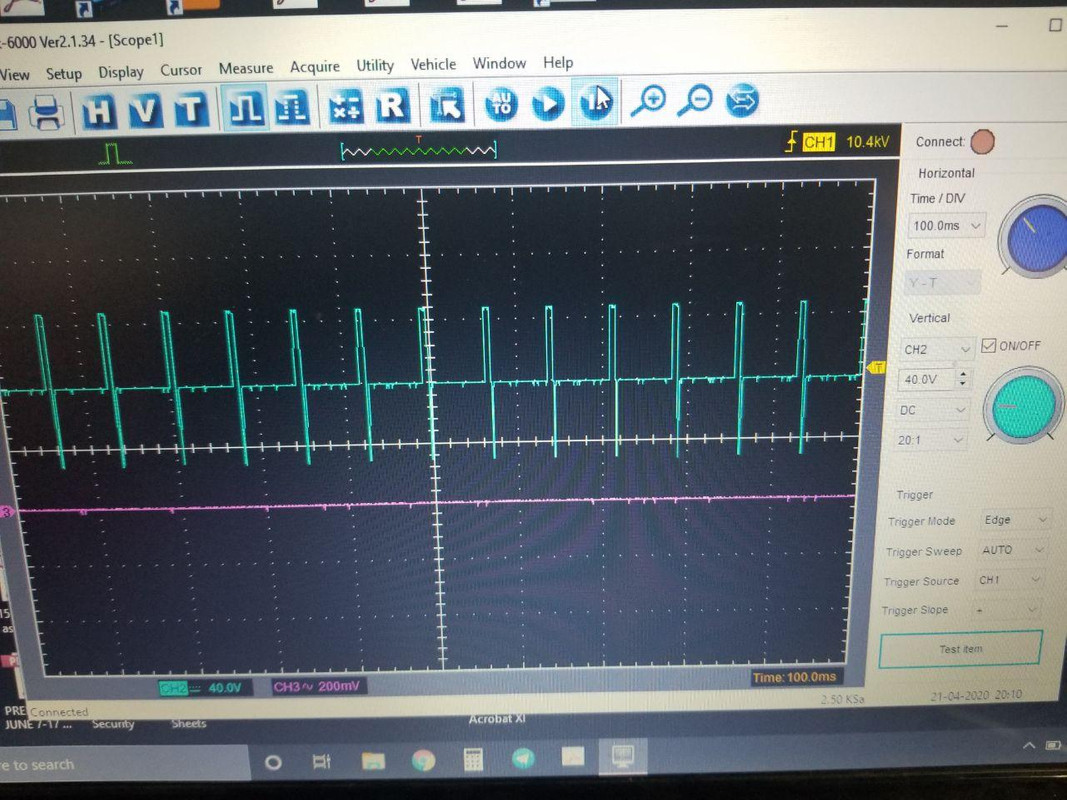

Wow I can't believe how far this thread has gone without a single post from me. It really shows what kind of guys you are, obviously more than willing to help. Here is some scoped images of the waveform that is made during my machine's cleaning process. You can see that it is definitely reversing the signal. It looks to be operating at ~14Hz, with a positive pulse width of 7.37ms. For some reason I can't get the negative pulse width to read but it looks around 2ms judging by the scope picture.
Also, you can see the voltage is the same as the converter itself - 48V. I think in the last picture I had my scope settings all messed up, but I am confident I got it right now.

Nice scope pics. Now the numbers look more believable. (Actually the previous numbers made sense, once I realised you had the probe attenuation of 20x but the scope set to 10000x :) ).
Just curious as to why the pulse edges are slanted a bit in the second pic but vertical in the third pic?
As asked previously, does your box have user-selectable pulse widths for the cleaning process, or is it one size fits all? Would it be an advantage to have selectable pulse widths to cope with different models of the injector?

I'm thinking the edges might be sloped due to the quality of software/scope and I just paused it at a bad spot. When it was running it bounced around a little but was mostly completely vertical.
For this box I don't need selectable pulse widths. I only care to replicate this waveform. The actual test bench I use has the option to set various waveforms and RPMs, and I'm not looking to replicate that right now.
