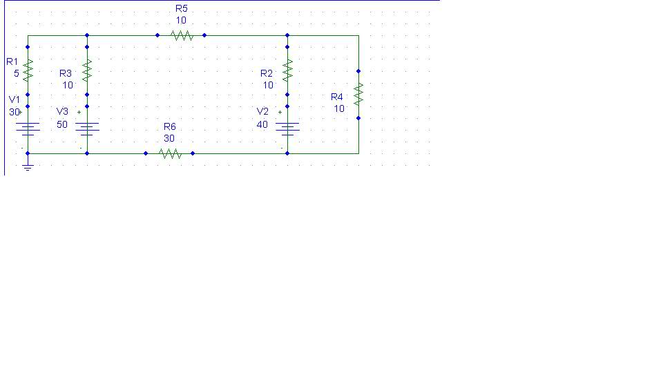

Hi,
I'm having an issue with a fairly simple DC circuit(6 rezistors and 3 DC sources) which seems to have goten the best of me.
My problem is that in the output file the most of the values are off the edge :confused:
This is my code :
Circuit
R1 1 2 5
R2 3 6 10
R3 4 5 10
R4 3 7 10
R5 2 3 20
R6 7 5 30
V1 1 0 30
V3 2 4 50
V2 7 6 40
.OP
.DC V1 LIST 30
.PRINT DC I(R1),I(R2),I(R3),I(R4),I(R5),I(R6)
.PROBE
.END
And the circuit looks like this:
All the help would be very appreciated.
Also on tinypic:Schematic

Your SPICE code does not match the circuit.
For example, V1 is connected to nodes 1 and 0 (ground).
V3 is connected to nodes 2 and 4 - node 4 should have been ground.
Also, in the circuit, you have wires running through the resistors, which will short them out.

Try labeling the nodes in your schematic, and see how different they are from the netlist that you generated.
