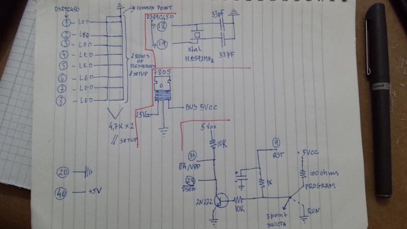

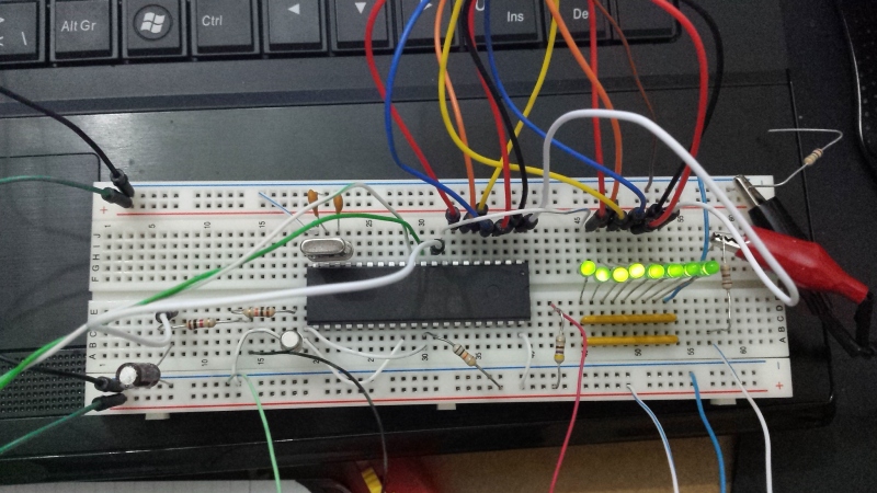

    Well, I'm a bit confused right now a part from that it's the first time I'm doing such thing.
    Well this is what i have:
    [​IMG]
    [​IMG]
    My bridge between laptop and my circuit is this:
    Lc-tech

    Well, you are using PL2303 based USB/UART bridge. DS have low current on port pins, and it is not able to drive LED's directly. For this you need to put transistor between port pin and LED.
    Here you can see my flasher/target schematic, compatible with Maxim flashing software...

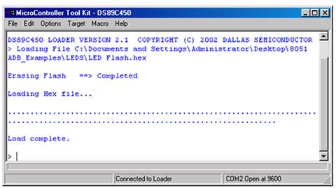

    Here is my flasher Win32 software in action...
    [​IMG]
    I didn't use Quartz that will give me requested baud rate for loader. I used PL2303HXD that support any baud rate, and made my own Win32 driver update for this.
    [​IMG]

    I'll try to explain what is missing in that previous schematic I posted a few posts ago.
    I'm using a cell phone transformer to indirectly feed the circuit, meaning that the negative thread of the transformer is connected to the GND bus of the breadboard and the positive thread is connected to a small resistor and this resistor is connected to a 5V voltage regulator that ensures the 5V to the breadboard's positive bus.
    I'm also using this small device to make the bridge between my laptop and the circuit. I'm not using the 5V coming from the laptop USB plug, meaning that only TxD, RxD and GND from that small device are being used.
    You talked about a push button device to switch from RUN to PRG mode and vice-versa. Well, I'm using a switch because it was an offer from a friend of mine. The thread from that switch that connects to the breadboard's positive bus has also a resistor to help avoiding any unwanted situations.
    Hope you understand my explanation.

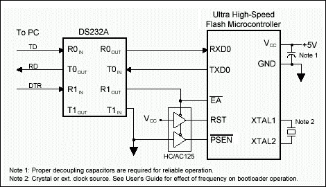

    As you can see on picture, use DTR output line from your small bridge device for switching between PRG / RUN mode. It is easier to control PRG / RUN mode from laptop automatically. Just add sn74hc125 logic chip to your circuit.
    [​IMG]

    I don't have any SN74HC125 with me to add to the circuit. But you're saying that as my circuit is, it will not work???
  17. josip
    Member
    Mar 6, 2014
    63
    12
    It should work, at least programing. Detailed description is here... http://www.maximintegrated.com/en/app-notes/index.mvp/id/3262

    Ok, I finally got it working... (After I have destroyed one DS89C450).
    I was doing 2 mistakes.
    The RxD pin from uC connects to TxD pin of FTDI and TxD from uC connects to the RxD pin from FTDI. I was connecting RxD (uC) <--> RxD (FTDI) and TxD (uC) <--> TxD (FTDI)
    The other detail was harder to find. As I don't have any stable power source I have used a cell phone charger (~16V output) and a voltage regulator and a resistor and tried to match the 5V needed by the uC. The problem was that I think in the first attempts I might have let passed way over 5V and probably destroyed the uC. Another reason could have been the ground reference from the regulator that was not welded and sometimes it could not be making a solid contact with the voltage regulator middle pin.
    Anyway I have 2 DS89C450. It was my luck. Now I'm using another cell phone charger but with around 5V of output combined with a 5V regulator. So, now everything is working.
