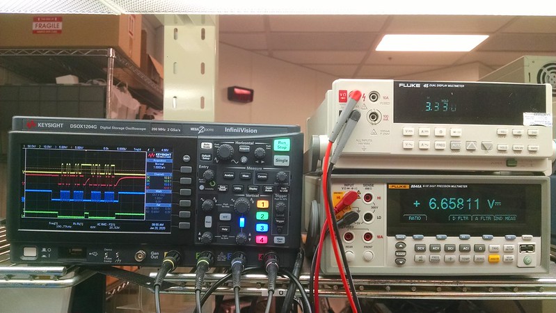

Sure, a Fluke 8846A or similar spec meter can easily see it.
12-bit DAC A/B output with 6.66 volt programmed on the bottom meter, 3.33 programmed on the top meter.
Very slick but a tad pricey!
