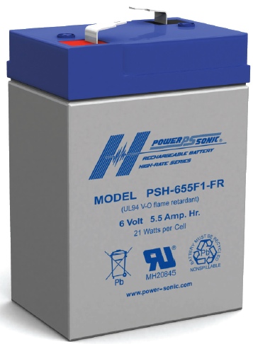

Hello, I am wondering if I can make a phone charger that has an output of 5.2V 1A and as efficient as possible running on batteries. I have 7805 voltage regulators and lm317's but when I use the 7805 with a 9v battery, it does not supply enough current to make my phone battery percentage go up...it just remains constant (I believe 300mA or so if I remember correctly). How can I go about making this? Any ideas? Thank you in advance

A better battery, and a switch-mode regulator/converter for higher efficiency compared to a linear regulator.
If it takes 4hours to charge your phone, the battery will have to supply 1A for 4h = 4Ah. I would use a 6V SLA, like this:
Even bigger, if you want several phone charges before having to recharge the SLA.
