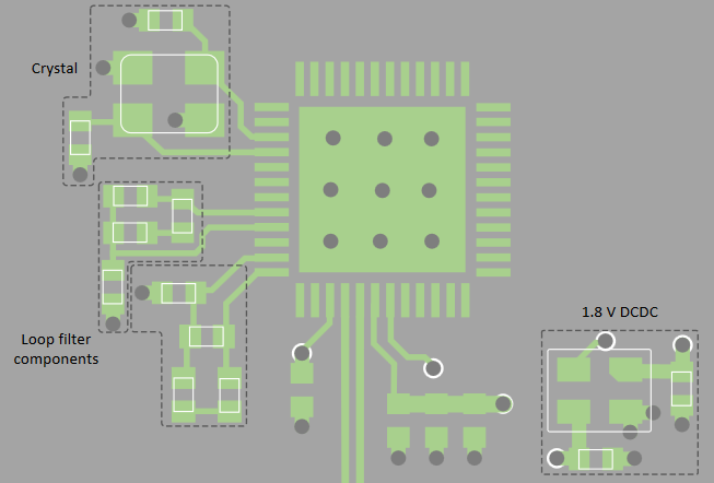

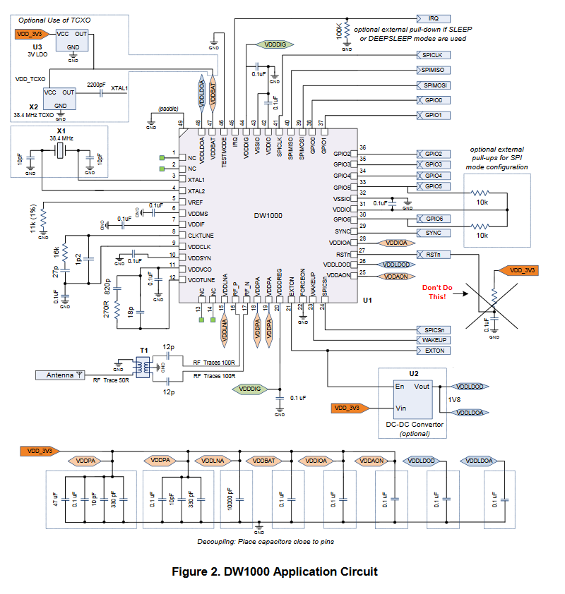

Are you using the DW1000?
Is the signal that is coming over the cable EXTCLK (38.4 MHz)? This is more or less a digital input. Changing the cable length wold cause a shift in phase between the clock source and the chip (phase being another term for relative time), but I do not see how that would affect the RF PLL if you are using the chip the same was as in the application circuit (Figure 37) in the datasheet.
Is the integrator an active circuit (includes and amplifier) or is it the RC network attached to VCOTUNE?
What is the nature of the problem, are you unable to lock in on the incoming signal?
What does your clock input circuit look like? Is the clock signal terminated properly -mistermination or lack of termination can cause the signal to become too small for the chip to "see" and this would be a function of cable length.

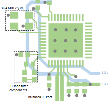

In the pictures you can find the used PLL filter.
