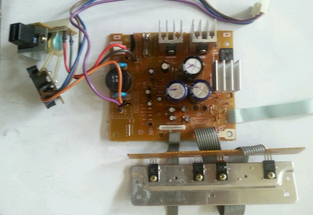

Hi all. I have a Pioneer DJM-500 mixer that is putting out distortion when the volume is up. If I turn the mixer volume down, and the amplifier volume up, it sounds ok. Also the bass seems to get very low when the mixer volume is up. I have tried different amplifiers, different cables, different inputs, with no better results. Any help would be appreciated. Attached is the link to the service manual.

The approach you take in order to diagnose this problem will depend on your level of expertise and the test equipment you have on hand. Do you have a DMM, signal generator and an oscilloscope?
I assume that you have a clean audio source and you have tried inputting to all channels.
The first thing you should do is measure the supply voltages using a DMM.
There are four supply voltages to measure with respect to GNDA.
Look at connector CN121.
1 - V-8A
2 - V+8A
3 - V-BB
4 - GNDA

Look at the power supply assembly.
You will find transistor looking devices with three terminals mounted on the heat sink.
Find the one that has markings NJM7915FA. Replace this.
You can find replacements from the usual suppliers Digikey, Mouser, Newark.
You may want to replace the NJM7815FA as well.
Make sure you get devices with insulated tabs and apply heat sink compound before mounting on the heat sink.
https://www.digikey.com/product-detail/en/njr-corporation-njrc/NJM7915FA/NJM7915FA-ND/805807
https://www.mouser.com/ProductDetail/NJR/NJM7915FA?qs=YkwXVBeUzeg1Sl1cPb/adg==
https://www.newark.com/stmicroelectronics/l7915cp/ldo-voltage-regulator-fixed-15v/dp/26M0593

Please measure the voltages directly at the 7808 and 7815 3-pin voltage regulators.
Input wrt (with respect to) Ground pin
Output wrt Ground pin
Pinouts for 7908 and 7915 are different.
Note that in your case the metal tabs are insulated and make no electrical contact with the heat sink.
