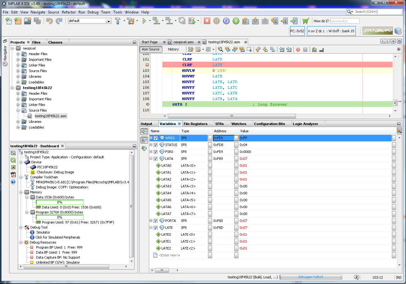

For now try the LED Blinking project I wrote for PIC18F45K22 @ 8 MHz Internal Oscillator.
Ur code is acting funny o_O
I just burned it and only output 0,1 and 2 are flashing on every port. :confused:
From the code it seems all the Leds should falsh ?? o_O but It's not.

Haha this I didn't expect. Wow, the mikroC simlator was clueless and simulated FF on all ports, but after taking the following listing generated by mikroC with jayanths c-code and importing it into mplabx mpasm, THAT simulator replicated your fault very well as hex 07 (or as you said "output 0,1 and 2 are flashing on every port").
The error is a bit funny and maybe not so obvious. I'm going to be a little evil again and say: Can you see what it is ? Clue: The LATE register is 3 bits wide.
C:
;LED Blinking.c,37 ::      while(1) {
L_main1:
;LED Blinking.c,39 ::      LATA = LATB = LATC = lATD = LATE = 0xFF;
0x006C   0x0EFF     MOVLW  255
0x006E   0x6E8D     MOVWF  LATE
0x0070   0xFF8CCF8D    MOVFF  LATE, LATD
0x0074   0xFF8BCF8C    MOVFF  LATD, LATC
0x0078   0xFF8ACF8B    MOVFF  LATC, LATB
0x007C   0xFF89CF8A    MOVFF  LATB, LATA
MPLABs result:
try:
LATE = 0x07;
LATA = LATB = LATC = lATD = 0xFF;
