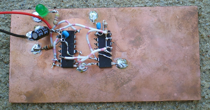

Build this with 74HC14, 2.2k, and a trimmer cap that includes 10pF within its range. Vcc must be 5V, and build the breadboard on copperclad with a ground plane. The "dead bug" technique will minimize stray capacitance (see example below). You should be able to get at least 12.6MHz.
DON'T use a solderless breadboard. Their stray capacitance is too high.
