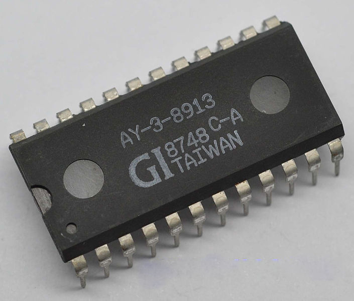

I have a project that uses a couple of DIP ICs with 600 mil height (in particular, a sound chip and a microcontroller
How do you find a short with hundreds of ICs and decoupling capacitors in parallel across the supply lines?
The culprit was a blob of solder sitting underneath a DIP IC that had gradually flowed over time.
So, one problem after 10-years of continuous service on a board with 100s of ICs sounds like a ringing endorsement to move full steam ahead on a board with two ICs that will be used (I assume) occasionally.
So, What audio chip are you using? I posted an old AY-3-8913 above.
