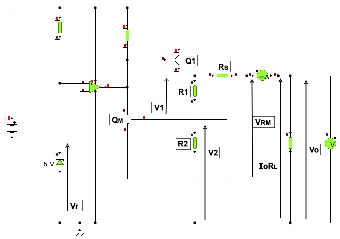

Please help me out to calculate the values of R1 & R2. what is the formula or how to derive it. i am attaching the circuit design. thanks
Design task:
Target specification for Current Limiting circuit
(i) Io [max allowed current] = 2A
(ii) Isc [fold back current] = 0.5A
(iii) Regulated output voltage Vo = 12V
d. Calculate the value of Rs.
Io = 2A
VbeM = 0.6A
From Ohms Law
Rs = VbeM¬¬ / Io
Rs = 0.6 / 2
Rs = 0.3Ω
e. Calculate the values of R1 & R2 to achieve the above data?
