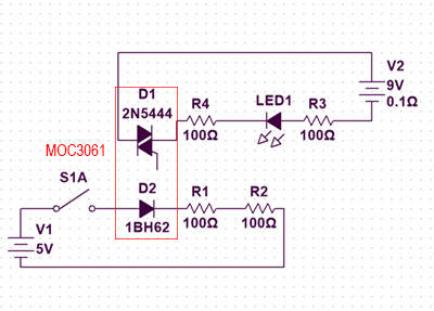

Hello!
It's my first time here on AAC. I bought some MOC 3061 optocuplers and I am planning to use them as switches to open or close another circuit. For testing purposes I've build the following circuit:
[/url][/IMG]
The 5V source is an Arduino with a button hooked up to act as a switch. The circuit I plan to control is powered by 9V battery and contains two 100Ohm resistors and a green LED1.
Can somebody explain why the triac driver (is this correct?) continues to conduct after the current stops flowing through the 5V circuit?
Any help would be greatly appreciated!
Because that's the way triacs work. To turn them on, they only need a brief pulse on the gate; to turn them off, you have to interrupt the flow of current through them. SCRs are the same way.
WBahn
Joined Mar 31, 2012
32,823
Because that's what triacs do!
Think of them as a self-latching relay. Once you power it up with a shot of current, the current that starts flowing in the main circuit keeps the device on. To shut it off, you have to momentarily remove the current in the main circuit. After that, it will be off until the next shot of current form the control circuit. This is why triacs are normally used in AC circuits -- the zero crossing is enough to shut them off. It sounds like you want a normal phototransistor output stage.

Your schematic is confusing -- it show two discrete parts (with discrete part numbers) but then with a red box around them and a different part number. Are you using/simulating two discrete parts or a single optocoupler?
Also, are you simulating this or describing the behavior of a physical circuit you've constructed?
I admit this schematic is confusing. I have the physical circuit in front of me, in which I am using the MOC 3061 optocupler. I used discrete elements in the schematic because i could not find an optocupler in the element libraries.
Your circuit isn't at all representative of an MOC3061 but, no matter how you've contrived to turn the TRIAC ON, the reason you can't turn the TRIAC OFF is because in order to do that you must reduce the current into the load to be close to zero while the gate signal is OFF.

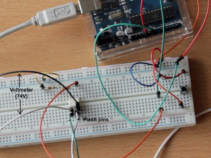

If your end use of this circuit is to trigger a photoflash, the MOC3061 might actually be appropriate for the job. Photoflash triggering is normally done by discharging a capacitor into the primary of a small step-up transformer, producing a pulse of several kV which initiates the ionization in the flash tube, which then discharges the main photoflash capacitor, producing light. If I recall correctly, SCRs or triacs are usually used for this purpose, as shown here, so you may be OK.

What I am trynig to accomplish is to make a circuit that could trigger the flash when voltage is applied to the optocupler by the arduino.
The flash I use is the Metz 30 bct 4. The voltage measured between the terminals on the foot of the flash is about 74V.
The actual circuit:
The upper part is the same as original schematic: 5v output from arduino connected over resistors to pins 1&2 on the MOC 3061. The flash is connected to pins 4&6 as is the voltmeter. When voltage is applied to pins 1&2, the voltmeter reading goes to zero immediately but the flash does not fire. The only way to trigger the flash is to (manually) short the pins on the foot.
I would appreciate some insight as to what might be going on.
