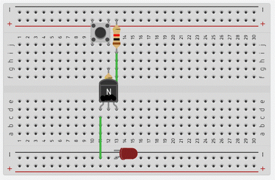

In your drawing, you have the collector resistor and LED shorted, the collector resistor isn't connected to the LED, and there is no power being applied to the board.

I think I see how to do it now.
One resistor goes to the collector of the transistor.
The other resistor goes from the switch to the base of the transistor.
The wire goes from the emitter of the transistor to the LED.
The long leg of the LED has to match up with the collector and the short leg matches up with the wire.
Is that right?

That looks better. But is the transistor E B C like shown, or C B E like before?
You may have to pull the transistor out and rotate it 180 degrees.
Yes, the transistor is E B C.
I understand, now, that the collector takes in the current and shoots it straight to the emitter. When the base gets voltage it stops the flow from the collector to the emitter.
I trusted the picture I saw on that other site at first and tried to rationalize how it worked around that.
Thank you, sir.
Not quite how I'd explain it.
You're using the transistor as a switch. When you supply a sufficiently high voltage to the base, you cause sufficient current to flow into the base to saturate the transistor (turn it on fully).

In any case, the LED isn't connected to a current limiting resistor.
In this case the LED used the collector 1K as the current limiting resistor. The LED is shorted out when the transistor switches on, and lights up via the 1K when the transistor is off. So it does not need a separate resistor.

Here is the correct way of doing your board above....
Since your button has only 2 pins, I shifted it from the centre to the lower part, so you can plug in your button horizontally and it should work. Not sure about the orientation of the LED, if it doesnt light just reverse it.
