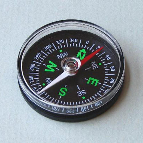

The magnetic field direction is referenced from S to N at the dipole. So, a magnet, a loop of wire, a current meter and the left hand generator rule........should indicate which pole of a magnetic is approaching loop.

The simplest compass is made by taking any magnet and gluing the end of a sewing thread to the magnet with super glue or maybe hot glue. Hold the string up with one hand and wait for the thread to unravel a little. Then the magnet stops turning, the side that points north is the north pole.
A couple notes though:
1. The magnet has to be suspended such that the two poles face outward.
2. The thread must be long enough to avoid any torsion from affecting the rotation after some seconds of untwisting.
3. If the magnet swings back and forth a little you can dampen this with your other hand, then wait for the untwisting to stop.
4. Stay clear of any large metal objects.
It's so easy. I actually used this idea once when going to a new place on foot where i took a bus to get there and had a map but needed to know where north was so i could use the map effectively to walk down the right streets to get there. It was a little fun really but i was lucky there was no wind because that would have made it too hard to use i think unless i went indoors.

Again, my goal was not to make a compass, but to identify the N/S poles on an unknown magnet. I now have several techniques (including the phone) to do this with. Sheesh, throwing a problem like this to bunch of problem solvers is like throwing a steak to a pack of ravenous wolves!

Yes but when you make a compass you make a way to find the north pole of a magnet. That's why so many suggestions to make a compass.
You dont need the compass itself, you just need to identify the N pole of the magnet, then you have a way to find the N pole of any magnet after that by just using your known magnet. You mark the N pole, remove the thread, then you have the magnet with known poles to use from then on.

Again, a compass is off topic.
I think you miss the point.
We all know that you know which way is geographic north.
I have a compass. Its red needle points north. Hence the red end is a north pole.
Now I can use the compass to identify which end of an unknown magnet is a south pole.
