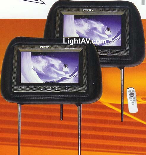

Hey guys! Came across this and thought this was an interesting forum so decided to join up and see if my question could be answered. I have a headrest monitor that uses an IR remote to be turned on. There is no power button to bypass the IR remote Signal. I spoke with the tech support of my product and they told me they no longer make this remote anymore and I can't get around this problem without replacing my screens. I beg to differ. I'm a mechanic and do computer/ basic electronics on the side as a hobby and wish to know if I can jump the voltage in pin and the voltage out pin on my IR reciever and should this power up my screen? I was unable to find a number on my IR receiver. Best I have is a picture. Hope someone can help me here as I'm unfamiliar with infrared. Thanks again guys!!

I don't have a picture of the remote as that is the piece I am missing. I have a picture of the back of the board. The monitor is a power acoustik model number pt-713hrs. These monitors came in the vehicle I bought and I would like to utilize them not replace lol.

It looks like this one. The remotes do look the same but the lovely people on the other end of the phone said that none of the remotes crossed to it??
