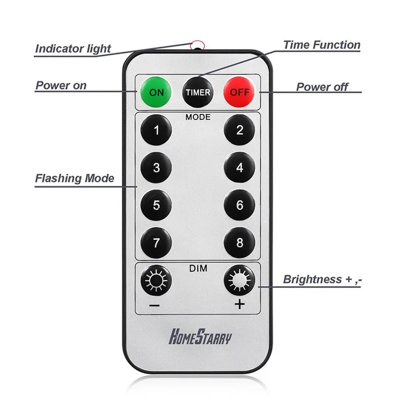

Ok, I'm a little confused. these are the lights that we are using (cant post amazon link so im going to attach a picture of the page below). I need to able to connect the transmitter to the existing remote, is this possible? And also, we will never be anymore than 30 feet away from each other. Thanks so much!!! I guess my main questions are: 1) would i still be able to use the remote that came with the lights, and 2) would this work with the receivers that are wired in on the light strands?

Sure it uses IR. Its range is only 12 feet and it says, "please point the remote to the battery case" and a yagi radio antenna is not shown on the transmitter and receiver.
Yeah maybe. Maybe even probably, but I would still like to know more.
I already posted a link where that 13 key controller was used for RF.

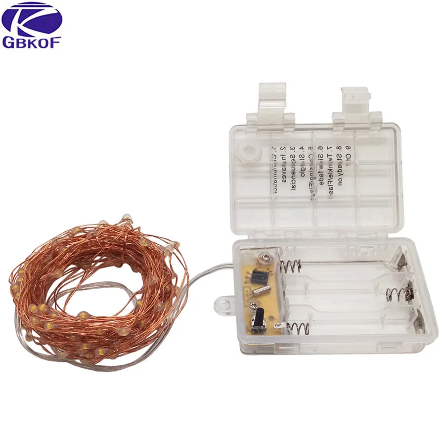

Look at this one. In particular, this pic, The LED on the controller is designated as an indicator light - meaning that you can see it illuminate when operated.
Is there a Yagi antenna on these ?
Here, you can peek inside...I guess that black three pin chip in this pic could be an IR detector - dunno.
The TS stated "sadly this remote must be facing the battery boxes to control the lights" but that is not proof positive to me.
I guess it is my skeptical nature. Funny that the first link to the product posted doesn't say IR - does it? In fact, none of the Ali links say IR or RF. Weird, but ok, probably IR.

Of course the black three pin chip with the bulge on it is a TSOP IR receiver IC.
The other system with RF coils has a solder spot for a missing ANT (insect?).
