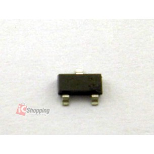

    Found this one, just unsure which pins are for what???
    [​IMG]
    Also, been looking at the capacitor's and they require a few more numbers:-
    xx uF xx v capacitor - any idea's - I presume the volts is to be 12V, but not sure on the first figure??

    1,775
    Rule of thumb on capacitor voltage is to double what you expect to see in the circuit.
    2N7000 MOSFETs will be easier for you to work with than 2N7002s.
    See datasheet, attached.

    As for which pin is which, go to: http://www.alldatasheet.com/view.jsp?Searchword
    You can look up any part and find out what pin does what.
