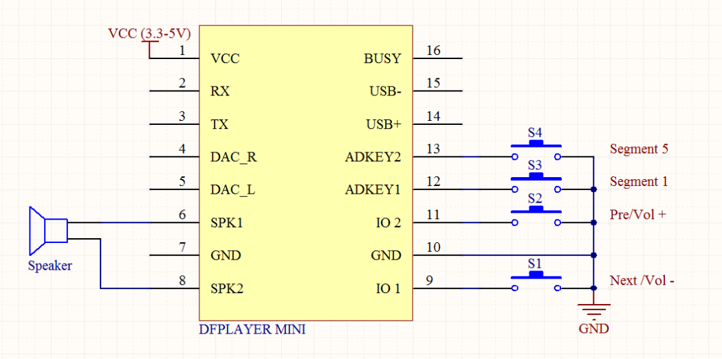

first of all thank you so much for replying, I appreciate it! Actually the problem is that the MP3 player isn't getting any power at all. Also, I'm not quite sure what a "pull-up resistor" means (I'm pretty new to this). The schematic doesn't show the correct pinouts for the mp3 player (I made it in Fritzing) so what I have is the emitter from the pnp connected to the +5 power to the MP3.
There could be lots of stuff going on or not going on. If I understand, you are trying to power up the unit using the PN2222 transistor (which is an NPN not a PNP) by provide current to the base via the PIR output.
Back up for a minute and remove the PIR/PN2222 alltogether and see if you can power up the MP3 and have it play a tune on powerup.
from https://www.dfrobot.com/wiki/index.php/DFPlayer_Mini_SKU:DFR0299#Pin_Map
Using the simplest IO mode, don't you have to do something with pins 12 & 13 to get it to play on pwerup.
After that, consider how much of a load the player, including the amplifier with speaker, represents and will the 2222 handle that? Then consider how much base current the PIR can provide and the gain of the transistor. Also whether or not you have tied the grounds together.

Thank you for your response!! I'm using a Gpd2846, not a DFMini. It does play the first (only) track on powerup when I just put the 5v to it. You're absolutely right; I messed up and wrote the wrong transistor! Sorry about that! As far as the load, I just have it going to a headphone right now, but even with nothing in the jack it won't power up (the LED on the player remains dark). So it might be that I don't have enough voltage going through the system. All of the grounds are connected...is that bad? I apologize, I'm such a novice at this!
