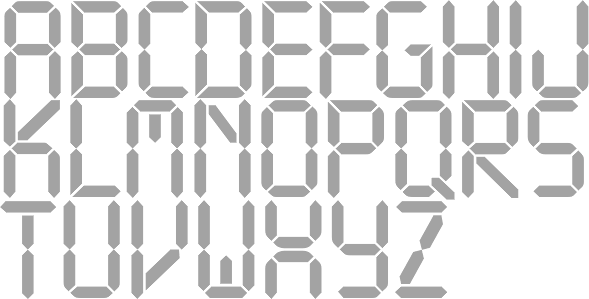

1) For a multiplexing has 4 to 16 decoder that it's as 74LS154, the output is low, then you should using 16 pnp to drive as "米" rice fonts leds. (Common Anode Type)
2 rice font leds - 14 segments LED.
4 rice font leds- 14 segments LED.
2) For a multiplexing has 4 to 10 decoder that it's as CD4028, it's need two piece, the output is high, then you can using ULN2803x2 to drive as "米" rice fonts leds. (Common Cathode Type)

If you use a 14-segment LED display, you won't be able to reproduce all of the characters you have shown. The "B" would not be distinguishable from an "8" nor a "D" from an "O" or "0" you would have to use lower case "d", "b", and "o". The letters "K", "N", "Q", "R", 'V, and "X" would all appear somewhat different than shown.
Thanks, I knew that.
On the fonts table also had some other errors as D and 0 were double error, K, N, Q, R, V, X were segment errors, the B and D can be shifting two left segments to the middle, then B and 8 will be different, and D and 0 also will be different.
The fonts table was linked from other website for reference, although I knew those have some errors for 14 segments, but I still made the link, because I was designed a program to display the fonts for preview, but I didn't copy all the fonts, if the op has interested in 14 segments then I will upload the file to the forum.
I saw some 16 segments led long time ago, and the fonts type were look better, but I haven't buy it.

ScottWang, my post wasn't really supposed to be critical of you; it was more of a caution for "newbies" that it wouldn't exactly be as "easy" as replicating the fonts presented. There were drivers for 14-segment LED displays, but I can't remember the part numbers offhand, and they would have been obsolete shortly after LCD displays hit the market.
ScottWang
Joined Aug 23, 2012
7,506
SgtWookie, I didn't blame you at all and I also thank you for your mentioned and complement about the fonts errors, whatever I knew or not, the true was that somethings wrong over there.
I did the thing as you very often, so I also hope when my post had anything wrong, someone could point out, thank you.
The fonts as below are matched the 14 segments led dispaly.(From Wikipedia)
