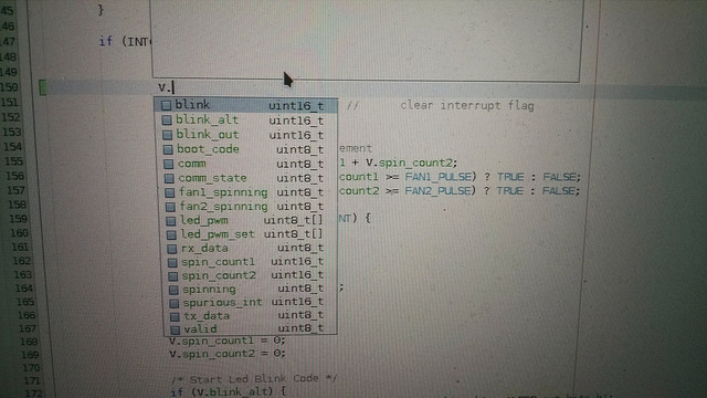

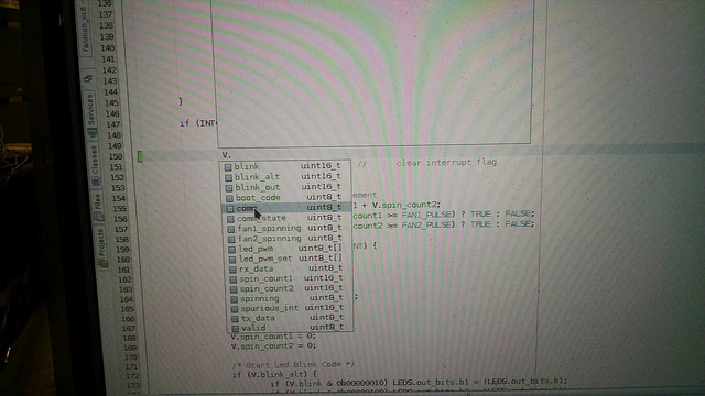

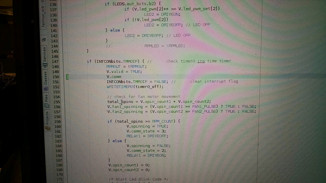

If you use structures with the correct header files then the IDE will track all the structure variable data components and show them in a selection box on the current source file being edited even is the structure is declared elsewhere.
Example: Use the variable V.comm from the V structure.
64-bit Linux MPLABX 3.60
Type 'V.' selection menu box opens
Select variable and click.
Done.
