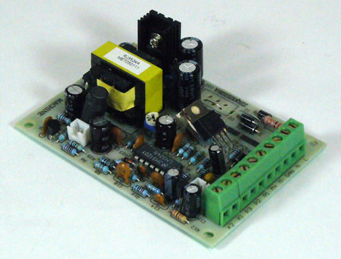

Hi all...hoping you guys can guide me on this...
I have a power feed unit for my mini mill that has stopped working. It throws a fault as soon as I turn it on, but even after clearing the fault it will fault again on turning the speed above zero. At low speeds the motor will come on briefly before the fault is triggered. I do have test equipment, but I'm not sure where to begin. The motor appears to fun fine (I think?) when run from a separate power supply, but it does give off a burning smell. I checked for continuity across the motor leads and I get around 5 ohms, and tried every rotational position of the armature.
I'd like to check out the control board as well - perhaps on my Rigol scope - but given that the motor can be driven forward and reverse I wasn't sure what to do with the probe ground lead and didn't want to risk damaging anything.
I would appreciate some guidance on further testing. Attached is a picture of the motor and a stock photo of the control board (haven't pulled the board yet as I'll have to unglue several items from the face panel first.

Managed to pull the control board out of the enclosure. Verified the power. No mains selection. It appears to be 110V only.
- Line and Neutral (no ground) come in to the board
- voltage verified as 120V AC at the terminal block
- Line passes through a [current limiting?] resistor (brown, black, silver, gold, white)
- Line and Neutral go though bridge rectifying diodes
- voltage after the diodes is a steady 167V DC
- nothing appears burnt or damaged on the component or solder side of the board
- no smell or smoke
- haven't checked for hot components (have IR temp gun), but I was not indicating any heat issue above
- rechecked with motor attached (to be sure), and problem still exists

Seems odd that the mains would go to a bridge? There appears to be a small transformer on board for the P.S.
Do you have a model/make of the board?
I thought it was odd too, but the mains go directly to the bridge diodes. I'm guessing the transformer is for the PWM? Haven't tested that far yet.
Board is:
SIEG MACHINE
ZZQ021226A
actual board:
MisterBill2
Joined Jan 23, 2018
27,863
I think that I see 5 volts per division for the scope trace photos, how do you measure 11.8 volts? AND, because I see no serious droop of the voltage on the PWM wave form, I would guess the supply is OK. Unless, of course, that is a no-load signal that we are seeing. Please let us know about that.
In post #1 you do mention a burning smell, so something must have been hot.
That could be in the power switching section, which is in the deep shadow part of the photo.
And what is that black object between R4 and D6?
Also, the top of C1 looks very slightly bulged. et us know iif that is just an illusion, or is it really bulged a bit.
The ~11.8V was at the full pot setting (100% duty).
Scope traces were with the motor connected and show about 15V peak at the 1/3 pot setting (low) and about 12.5V peak at the 3/4 pot setting (high). That seems significant to me. Peak voltage continues to drop and gets to about 11.8V at the full setting (100% duty). This would explain why the motor doesn't appear to increase in speed at all from 1/3 all the way to max setting.
From the motor. And it has that smell whether running or not. I'm discounting this as an issue.
Inductor L1. Probably for the PWM oscillator?
Also, the top of C1 looks very slightly bulged. Let us know iif that is just an illusion, or is it really bulged a bit.
It's just an illusion. All caps are perfectly flat, without any hint of bulging.

I can still test that chip, I think. From the "stock" photo it appears to be a LM324N quad op-amp. My board has a label over a scratched-out chip.
