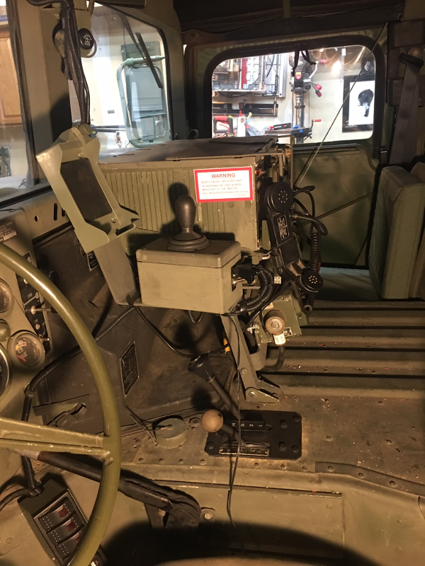

I am working on a project to connect a military surplus remote-controlled spotlight to a joystick. The light came off an MRAP and the joystick is a turret control joystick retrofitted with arcade joystick guts. Supply voltage is 24v DC from a HMMWV's power system.
The joystick contains four single pole momentary switches. Because of the design of the joystick, switches opposite of each other (left/right and front/back) cannot be closed at the same time.

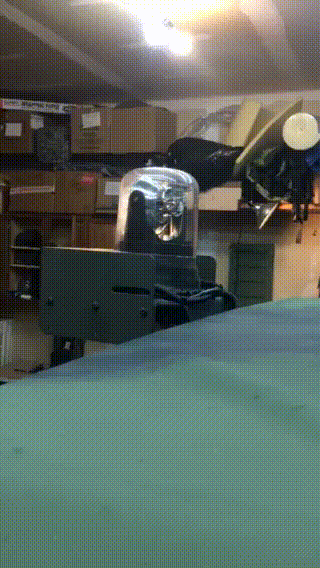

The light is controlled by two pairs of motor leads. One pair controls elevation and the other rotation. Applying 24v to the left/right pair turns the light in one direction (i.e. right). When the polarity is reversed, the direction of movement is reversed (i.e. left). The elevation motor works the same way with one polarity moving the light's point of aim up and the opposite polarity moving it down .
I've noodled on this a fair bit, but so far have been unable to come up with a circuit that will allow me to reverse the polarity of the motor control leads using only the SP switches that are in the joystick. I'm guessing that my SP switches may have to close a DP relay, but was hoping for something simpler.
I have a moderate familiarity with analog circuits, but that's mostly from experience with garden railroading. Any advice or suggestion would be greatly appreciated.
