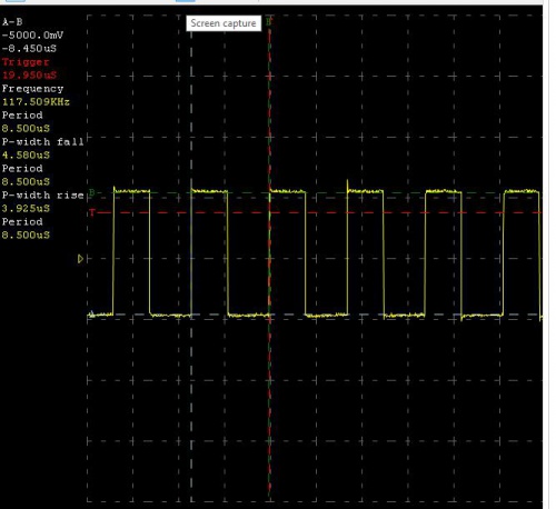

AnalogKid, I think I can see where we are "talking past each other", you're talking about overall precision and I'm talking about code not executing immediately. Slow code execution (lag?) is what I'm trying to avoid. Lag could be accounted for in the code if it was a whole number, but multiple tests I've found show it's not.
ATmega328 can operate with a clock frequency of 20MHz. That gives you 0.05μs resolution ±0.001%.
Even if you use an Arduino running at 16MHz, that will still give you 0.06μs resolution ±0.001%.
I completely understand that the ATmega328 clock has high resolution. The PROBLEM is code doesn't flip pin states with just 1 clock cycle on the Arduino, and this is why I don't want to have the Arduino controlling the solenoids. Even the most efficient code on the arduino can't flip an output pin close to 0.06us. Here is a picture of what happens when basic code sets an output high then low continuously, all without any delays added. It takes 4.15us to set the output pin LOW (which effectively gets added to the duty cycle). Isn't 4.15us much larger than 0.06us, or am I crazy?
(https://learn.sparkfun.com/blog/1687)
Here's another I found that gets it as low as 0.375us. This will probably work for me, but it certainly isn't 0.06us.
https://emayssat.wordpress.com/2012/04/10/the-fastest-way-to-change-arduino-digital-ios/
YES I know some advanced hardware would do this, but I came here for help with the "junk" that I had. Nobody has even explained why you can't have 2 mosfets in parallel. They're used for mosfet NAND gates for signals, so why can't 75A mosfets do this with a few amps?

Do you really need 60 nanosecond precision driving a solenoid valve? I would think variations in the valve's metallurgy and spring constant would introduce more timing variation than that. Or, for a snarky facetious retort: Why not 1 ns? 1 ps? OK, enough of my wit and humor.
I'm not a grand wizard, but I've done enough programming to know that you never will get that kind of repeatable precision from any code more complex than three NOPs in series. If:
then we're back to an external clock and divider to get the FET drive waveforms. If part of the external divider is a programmable downcounter, then you can change the output pulse width through the arduino without affecting the system resolution. Is this more like what you're after?

There is no explicit problem, and that is how some AND gates are constructed internally. But it almost always is lower cost and higher reliability to have one power device and do the logical control functions at the logic level.
BTW, two power MOSTETs in series back to back (or source to source) is an excellent way to replace a power diode for much less power dissipation and voltage drop in things like reverse polarity protection and battery management.

THANK YOU AnalogKid, that's basically what I was asking from the beginning. Teach someone to fish, as they say... I'll end up trying both direct IC control and the original idea now that I have a permanent scope to use (yay!). My older model seems to test out great with this scope, although it's hard to nail it due to the programming loop creating a variable period (every 6th pulse has a longer off-time).
My remaining questions are with direct control - will my chosen mosfet driver work with the IRF1404Z? Will I need any limiting resistor between gate & driver? The two mosfet's I'll be using will have a gate capacitance (Ciss?) of 3300-4300 pF and the driver can supply up to 5 amps.
