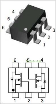

The LED is always on in a dim state, it never completely shuts off. But it will brighten when the GPIO pin get pulled high manually.
cmartinez
Joined Jan 17, 2007
8,759
What did you do with the other nFet included in the chip? That is, have you connected pins 1 and 2 to ground, or did you leave them floating?
Gpelon
Joined Sep 17, 2019
7
Another thing, what MCU are you using to drive the nFet? Have you made sure its GPIO is configured as a push-pull output?
The other channel on this nFet has this identical circuit. And I’m using a stm32 which is configured for push/pull.

They are not down to 0. Vg at LED1 is 0.04 V and Vg at LED2 is at 0.24 V
So, most likely there's something going on with the GPIO's .... I would disconnect the gates from the MCU's pins (but leaving the 10k pull-down resistors), and then test them by by manually connecting and disconnecting them to Vcc. If they work as planned, then definitely there's something going on with the MCU...
There are four ways one can normally configure a GPIO:
  1. push-pull output
  2. high-z input
  3. open collector output
  4. quasi-biderectional I/O
Maybe you've accidentally configured them as #3 or #4?

I’ve actually already been trying to manually pull the signal high or low on a breadboard and I’m still getting the same issue, so it’s not the MCU. What are some ramifications of overheating the mosfet during soldering? Maybe that caused an issue?
