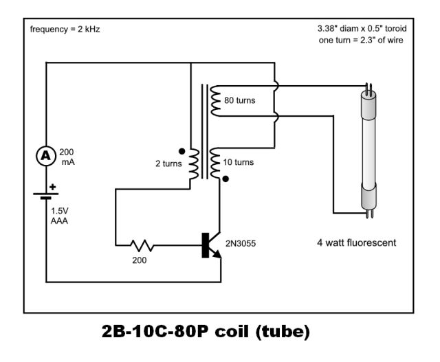

dont use a 2n3055 of course. Make the 220 Ohms larger. and use some kind of 20V zener diode on the output. Adjust until you get the required voltage.
inwo
Joined Nov 7, 2013
2,419
I have some Zener diodes, whould I just place it in line to the positive side of the device, then connect to the battery?
Yes, either line.
Use a zener value equal to the voltage you want to dump.
Remember to connect backwards or it will just dump .6V.
