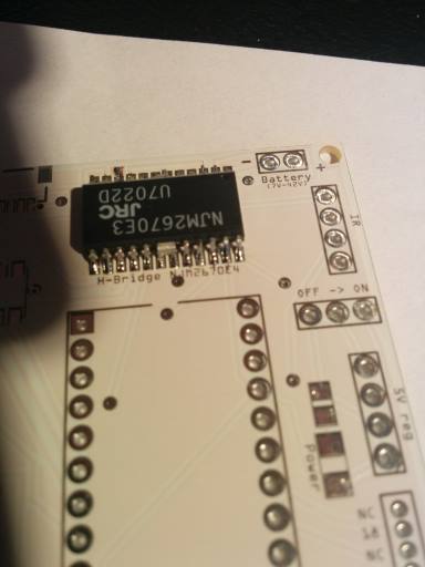

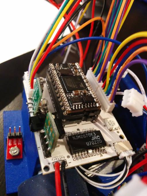

The board I'm making contains the Mini. In the center of the board I've got a 24-pin socket for it, and surrounding it I've got a motordriver, connectors to ir sensors, rgb led, 5V regulator, battery connector etc.
So the Mini is in a 24-pin socket in the center of the board.
Here are two pictures from the first prototype.
Before components are in place:
After components are in place:
As you can see the Mini has TWO sockets underneath it. I've soldered the bottom one to the board, and whenever I need to reprogram the Mini I have to pry the two sockets apart. The top socket is there so that I don't break the legs on the Mini.
So instead of this routine I want to just plug a micro USB cable directly to this board.
