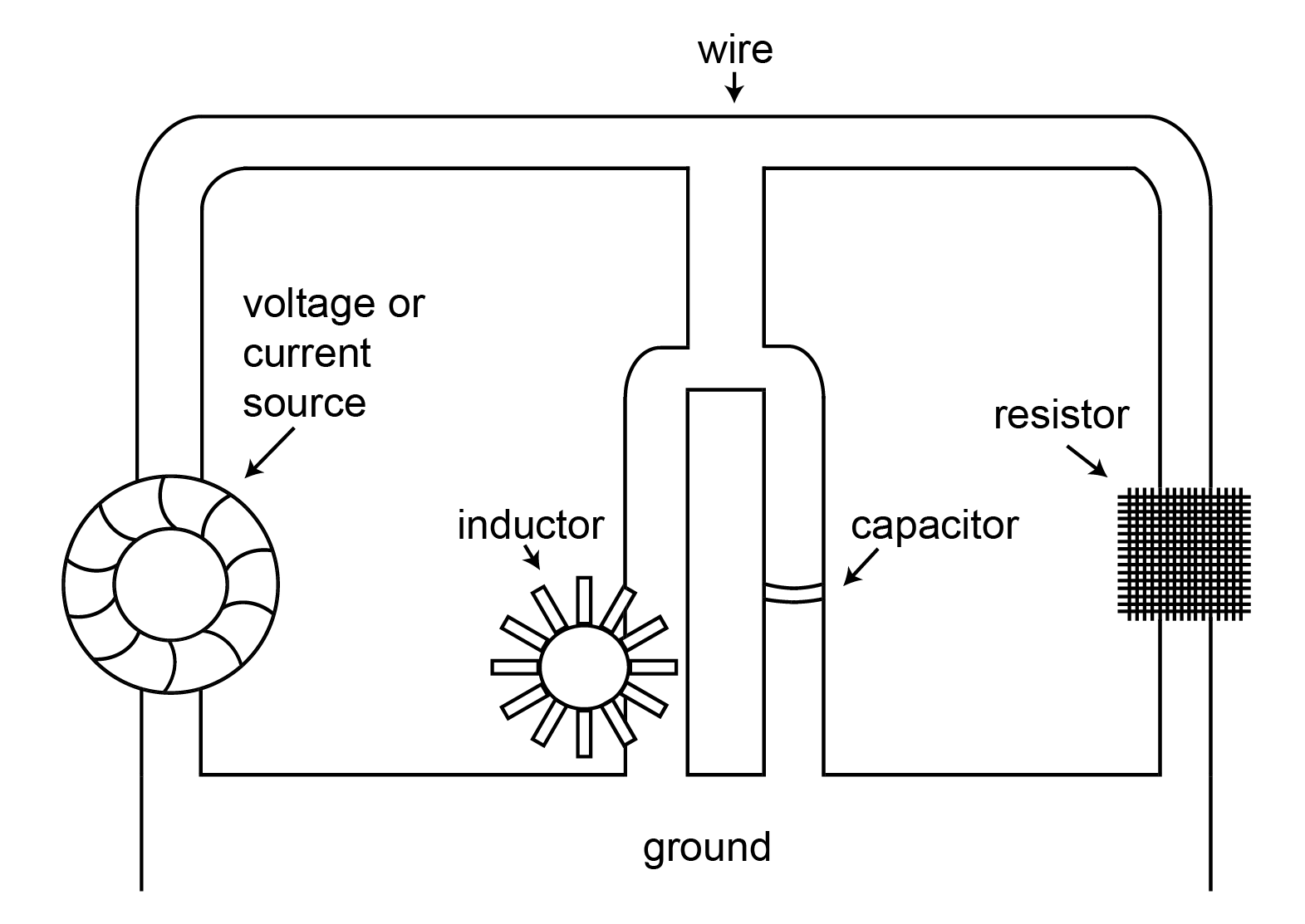

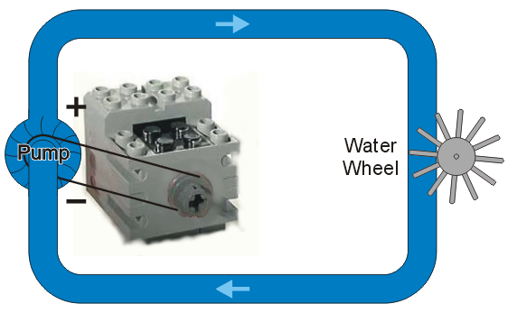

The main reason I say that is typically we model inductance/inductors in that analogy with external devices and not use the media, like this where the driving force is water pressure in a closed loop and/or gravity in a open loop. IMO to equate the mass of water directly to inductance is a poor physical analogy either way.
https://ece.uwaterloo.ca/~dwharder/Analogy/Inductors/
Initially, as the water wheel has mass, it does not turn (that is, it opposes the force of the pump). However, the force slowly begins to cause the wheel to turn and soon the wheel is turning at a rate equal to the flow of the water, as is shown in Figure 2. If the water is not moving, the water wheel will oppose any flow. If the water wheel is moving, it will resist any change to the flow. If the power to the pump is turned off, the water wheel will continue to turn.
https://www.allaboutcircuits.com/technical-articles/understanding-electricity-with-hydrodynamics/
An inductor is also very easy to compare, and if you've ever seen a water mill operating it'll be even easier. The inductor is like the wheel being propelled by the moving water; it will resist an initial flow or any change in flow once it is already turning at a steady rate.
