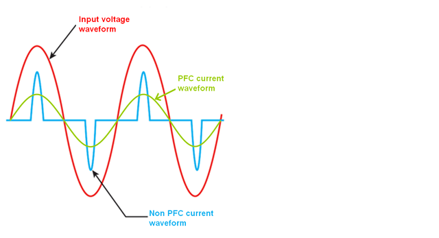

Hi buddy i think you are made an mistake diferent from AC shifting in phase (current vs voltage ) in an SMPS the only difference that make pf low is that we have an very short period where the capacitor charges itself (when the voltage aloud to the current to flow ) an buck topology would make that be more linear by lowering the voltage an making the system draw current in an more wide angle of the sinusoid

Thank you for the graphical illustration. I was not aware that this situation existed much less that it required correction. With sinusoidal waveforms for current and voltage the pf is the cosine of the phase angle between the current and voltage waveforms. What does the calculation of power factor look like for the red and blue waveforms?

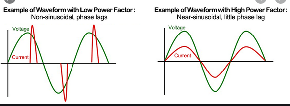

Sorry buddy i dont know if you are being sarcastic or not but in short i dont know the calculation exactly but when the current curve is more close to the sinusoidal curve we have an better PF with out any current control the current wave is mess up

No sarcasm. This is in the realm of "new physics" for me and I am genuinely interested in the method of establishing the actual power factor without correction for the purpose of determining how close we can get to ideality for the waveform on the right.
EDIT: I see the problem. The term "power factor" is properly applied ONLY to sinusoidal waveforms with the same frequency. What can be done with the non sinusoidal waveform is to decompose it into a sum of sine waves. Only the component at the same frequency as the voltage waveform will contribute to the power factor. That is why it was "new physics" - it doesn't really apply to this case. I don't know why this characterization has gained currency, but who am I to argue.
