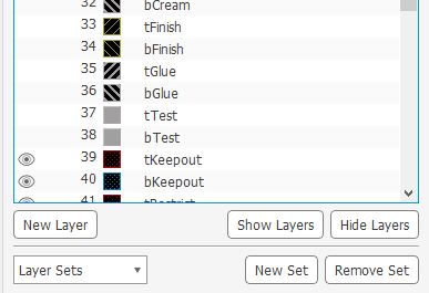

anyone tell me how to print out a layout in eagle? I just want to print the copper layer of a board without the part layout or any other stuff. I have tried viewing the top layer only but it doesn't seem to do anything.
How do you guys print out copper layer?

Use the Display button to select the metal layer you want to view, plus pads, vias, and, maybe, Dimension.
When you print, make sure select the Style options you want (e.g. Black, Solid, and, maybe Mirror). Select scale factor (usually 1). If you set page limit too low, printout might get scaled.

Again I don't use Eagle but I think you can go into: View / Layer settings and once you click on a layer you can chose to show or hide it
Now I might be wrong but I think this is where it's done.
