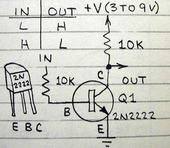

Sorry, I just had another long senior moment-- now I remember why I added the invertor; if reset state is used to turn on LED, then the day-night function is negated. Let's put the BS 170 back in. Now I'll try to get back to sleep.
But you are now sinking current instead of sourcing it, so does that invert the function? (I haven't been following the thread closely, so my observation isn't worth much.) You might also consider replacement trailer lenses like this. It's a Grote 90301, but they are available in other colors. Or you might want the entire lamp housing; it should be water resistant.

A CDS is a type of LDR light sensor. http://en.wikipedia.org/wiki/Photoresistor it's in the schematic, it's the resistor with an arrow through it.
The circuit will support Red Green or White LEDs by simply changing the current limiting resistor. A three position DIP switch has six combinations. The PIC can use it to run different flashing sequences or even simply on could be a combination.
If you want to drive powerful high brightness LEDs you'll need to add a driving transistor e.g. PN2222A

Thank You for clearing that up for me. How / where would the driving transistor be hooked up into this circuit?

A possible driver would use a PNP transistor or logic level p-ch MOSFET. For the 2N3906 ,woulg go up to about 100 mA which could be quite bright.
