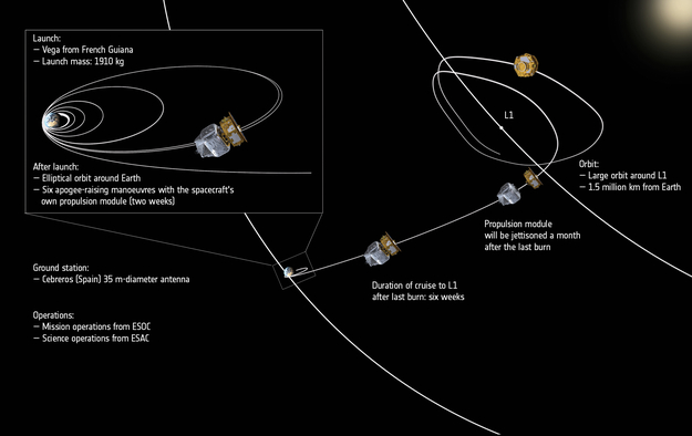

So where did they put this thing?
16,471
From their page.
"Operational orbit is a Lissajous orbit around the first Sun-Earth Lagrange point, L1, after a transfer trajectory from a low-Earth parking orbit"
"The operational orbit for LISA Pathfinder is a 500 000 km × 800 000 km Lissajous orbit around L1. This orbit has been chosen because it is an intrinsically 'quiet' place in space, far away from massive bodies, which induce tidal forces on the spacecraft; has constant illumination from the Sun; and has a quasi-constant distance from Earth for communication. This orbit fulfils the stringent requirements of LISA Pathfinder concerning thermal and gravitational stability.
This Lissajous orbit, with period of 180 days, is unstable and periodic station-keeping manoeuvres will be required - amounting to about 1.8 ms-1 per year - which will be performed using the cold gas thrusters of the spacecraft's micro-propulsion system."
http://sci.esa.int/lisa-pathfinder/56675-lisa-pathfinders-journey-to-l1/
http://www.space.com/30302-lagrange-points.html
