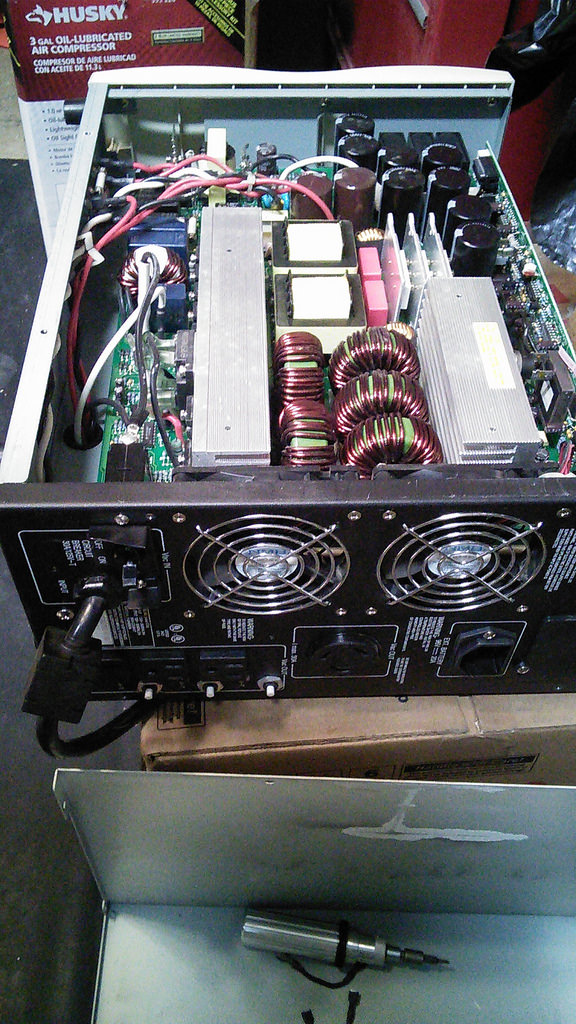

The fully online UPS in general are good, as you point out there's no switch-over delay, or related noise. In my personal experience with the smaller APC SmartUPS units, they run the batteries hot for some reason, which dramatically reduces the battery shelf life. I'm not sure if the unit itself is just warm all the time and that heat gets to the battery, or if they just over charge the batteries. The rack mount SmartUPS at work does not have this problem and we get many years from the batteries there.
The larger rack units are build like a battleship. I'm replacing the batteries on a unit (online but not APC) that's was in service at home for many years. It's nice and clean after blowing out years of dirt.
