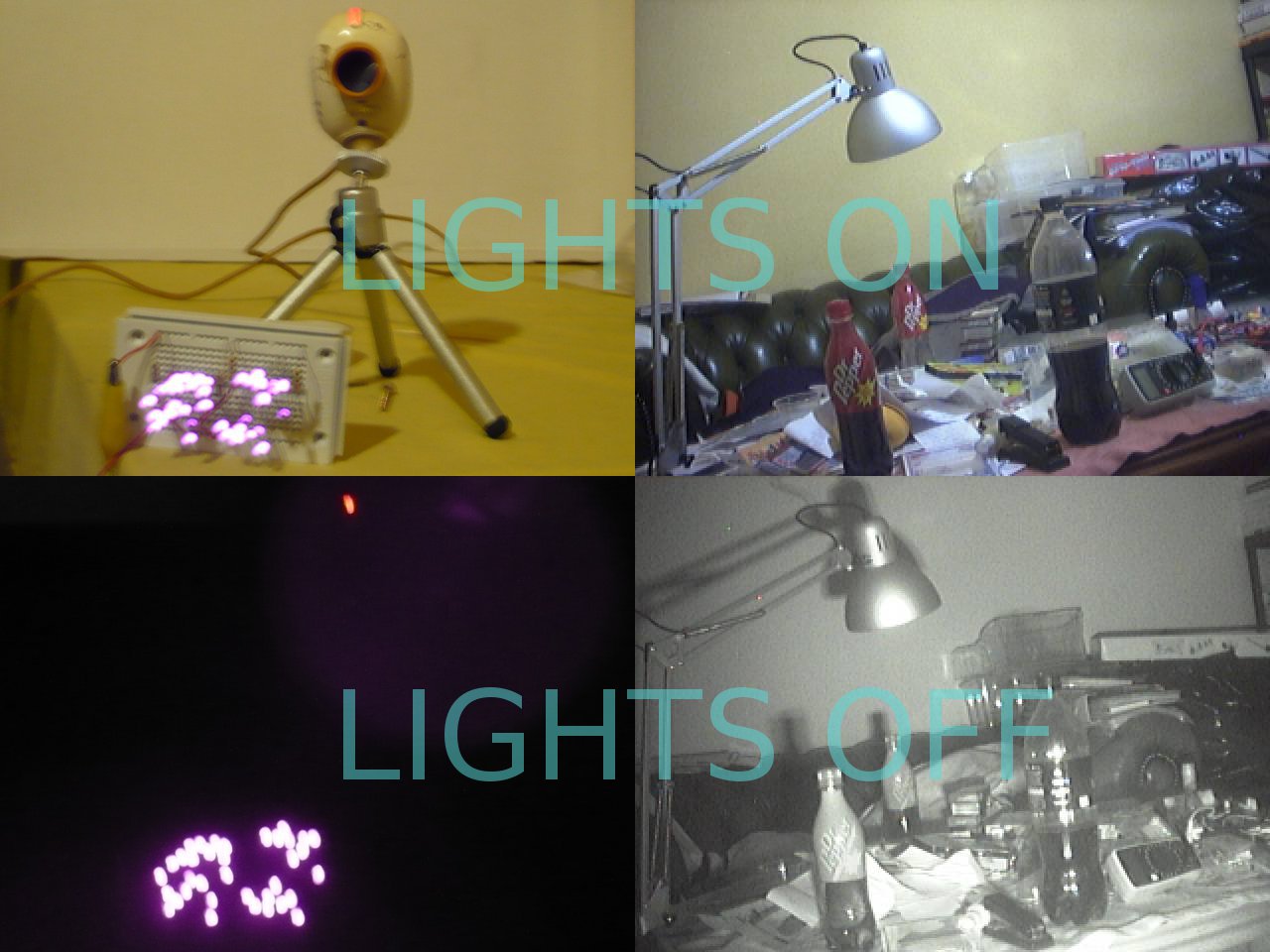

    Gotta love infrared. Go for LEDs, bulbs are an overkill for hunting imo.
    I sometimes leave a camera in the basement. There is... stuff happening. But not always. Next will be a wireless cam in certain buildings with certain history. The nice thing is nobody can see and snatch your camera and illuminators.
    Best to use the 940 nm wavelength variety, they will never visibly glow.
    There are already some cheap hardcore infrared high power leds for the same price as normal ones. Best thing is, since they are far red, the Uf is very low, as low as 1.2V. Several AA rechargeables in parallel will feed a 5W star for a whole night.

    Make sure you get a decent power units, 20 mA is not going to work very well. The photos above show a bunch of 50 mA conventional leds in action.

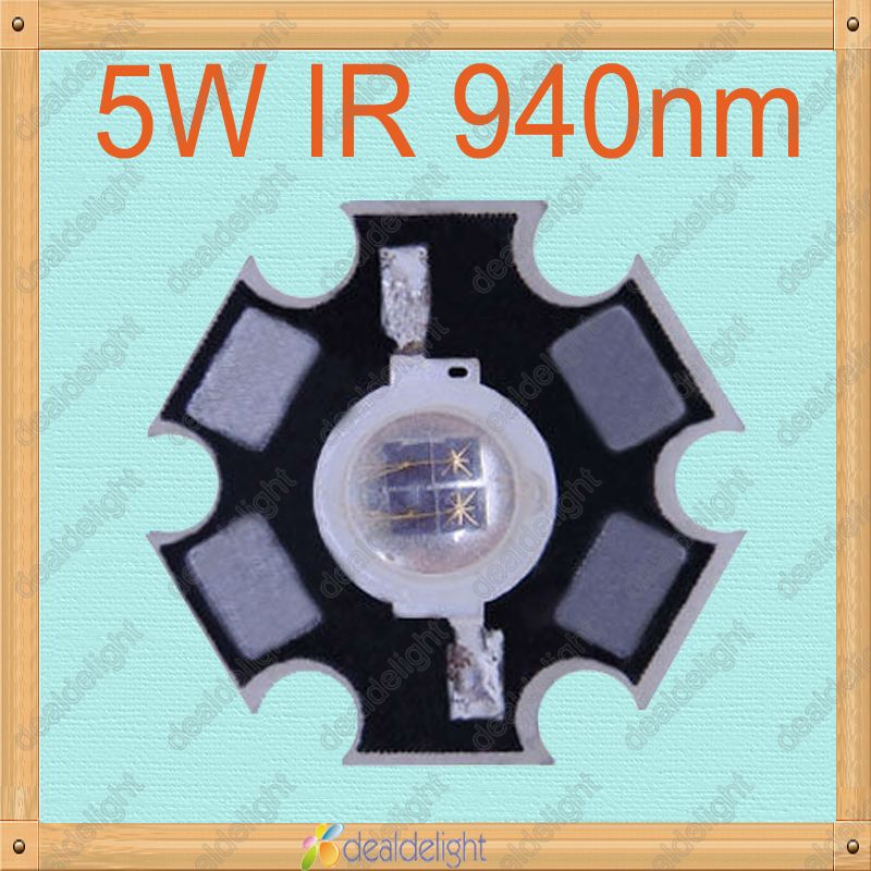

    Looks like this one might be our guy, eh? http://www.ebay.com/itm/1pc-5W-Infr...143?pt=LH_DefaultDomain_0&hash=item5669a19b1f
    As with any LED, I can adjust the current as appropriate, right? I.E., the 1400mA is the MAX rating, you set what you like with a dropping resistor....I have to decide on what to use to power these with, and come up with a reasonable life expectancy. I like the idea of using one unit like this, tho, rather than having to make a box with 20 indiv. LEDs that have no reflector!
  6. doller
    New Member
    Sep 28, 2012
    14
    3
    Yes, the same principles apply.

    Thanks for the idea, Richard, but I think power could be a constraint with those. He just wants me to make something "ghetto" for him, rough & dirty. The 5W units are about $6 on Ebay, so we'll try them, but if they aren't good enough he's going to have to fork over the dough for something nice like one of those! ;)

    Don't give up on the smaller (say 100 ma) ones. If you use a 5 watt one the current will lead you away from a resistor and into a current source. It will also need a heat sink.
