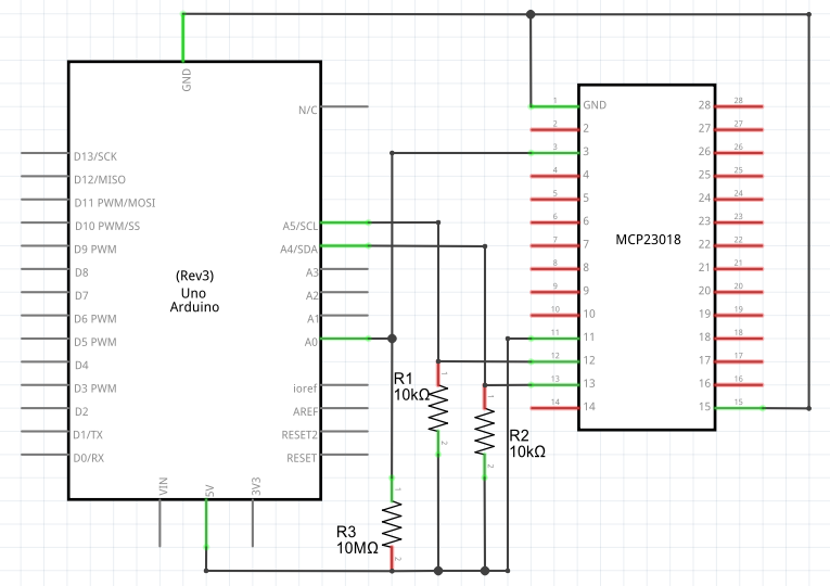

I can make a schematics of my circuit if you would need that. General info about it:
- SCL and SDA lines are connected to the Arduino UNO's analog input pins A5 and A4, and both have got a pullup resistor at 4.7kOhms to +5V.
- MCP23018 ADDR pin is connected to GND/0V and Vss to +5V.
- GPB0, which is connected to Analog pin A0, also got a pull down resistor at 10MOhms
I'd guess there is more connections the I2C device needs to 5V/GND maybe.

Shouldn't both work? I have added pullup resistors both internal and external, as you said I should.
Something is wrong here :/
Maybe something is wrong with my circuit, so I made a schematics of it, just in case there is something wrong there:
(this image, with an EXTERNAL pull-up resistor)
Thanks a lot!

I saw this thread as I was trying to troubleshoot this exact circuit. Since it looks like it didn't get fully resolved, I'll throw in my results...
My problem was that I wasn't getting any acknowledge back from the device. You can tell this if you return the value given by Wire.endTransmission(). See library documentation here. If this is the same problem that you are having, which I suspect you are, then you likely are not biasing the reset pin. The documentation on this for the MCP23018 is fuzzy. The only place it says you have to bias this pin externally is in table 1-2 which is the SPI pinout description.
Anyways, try putting a pullup resistor (1k or so) between reset and power.
