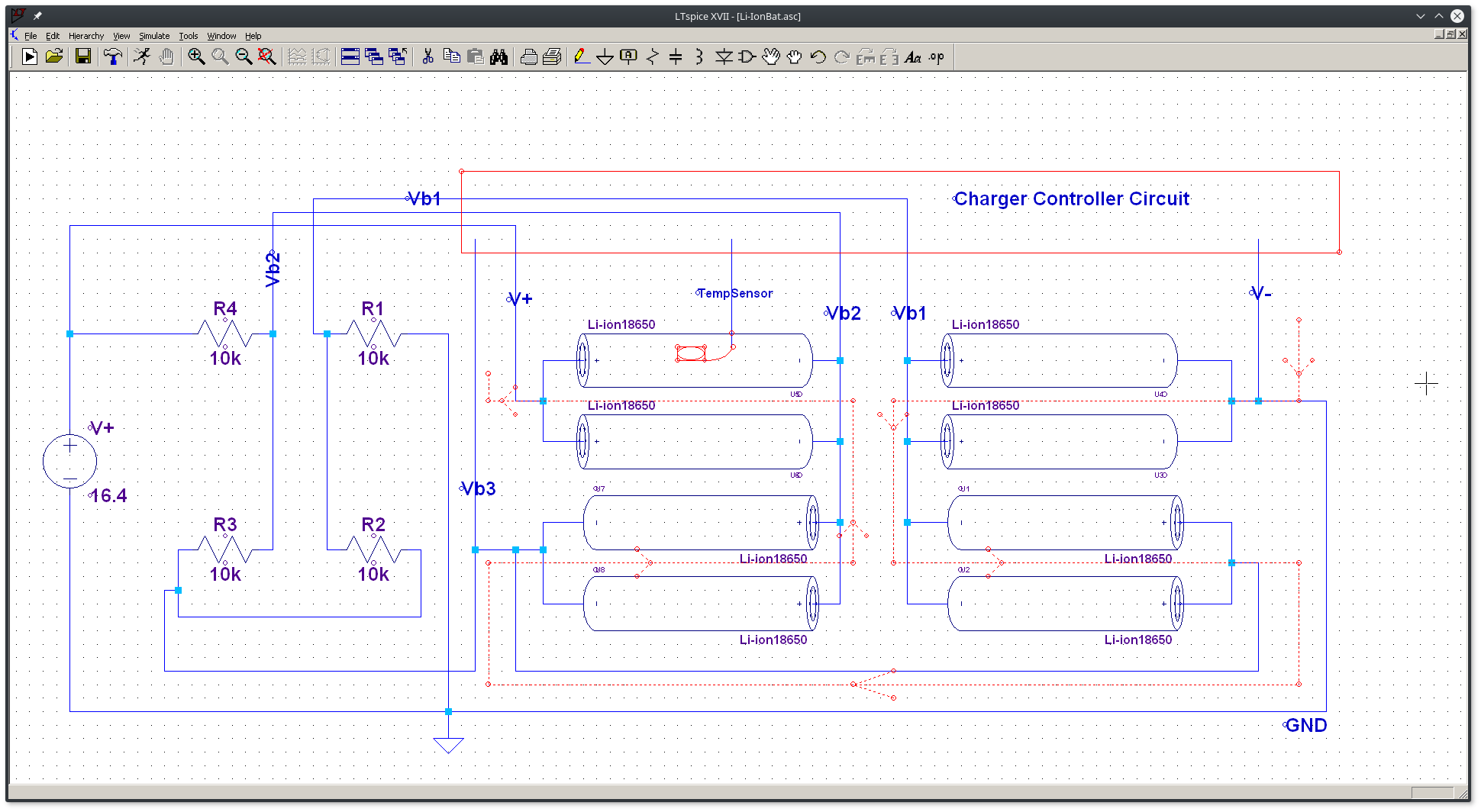

There is often (almost always) a battery management chip as part of the battery pack. One of the functions of the BMS is to detect if the battery has been discharged to below a certain voltage. If a Li-ion battery has been over-discharged, it is much more likely to fail catastrophically during a following charge. If you just disconnect the existing batteries, the BMS will see this as an excessively low voltage condition and disable charging as a safeguard.
Whether the low voltage detect applies to the battery as a whole, or whether it is determined on a per cell basis I can't say - it might be either depending on the BMS. And the method of resetting is also dependent on the particular BMS.
Ok, I'll try to come up with a solution to keep the voltages at all points (+, Balancing spot 1, Balancing spot 2 and baancing spot 3) at the same level as before disconnecting!
Edited;
I'll try something like this:
Ylli
Joined Nov 13, 2015
1,092
I'd reduce R1 - R4 to 1K instead of 10K. Then add a 100 ohm resistor inline to the V+ line to the top left pair of batteries.

I already have the circuit with the resistors of 1kΩ and a current limiter resistor at the input of 100Ω.
I have 2 questions:
Can I o the soldering without the external power supply already connected? I think I can. The external power supply will only be needed when I'm about to remove the old cells. I guess.
The other question is:
I have only soldered the ground and the + of the resistor circuit to the gnd and + of the battery pack (and charger controller). Now I'm measuring the voltage at those 3 points of interest at the resistor circuit and I'm having small differences in the voltage with respect to wha tI'm reading directly at the battery pack same (equivalent) 3 points. The biggest difference is of about 0.3V. Is this due to the fact that I still on't have the external power supply connected? Can it still be done even if after I connect the external power supply, this difference of 0.3V is still there?
