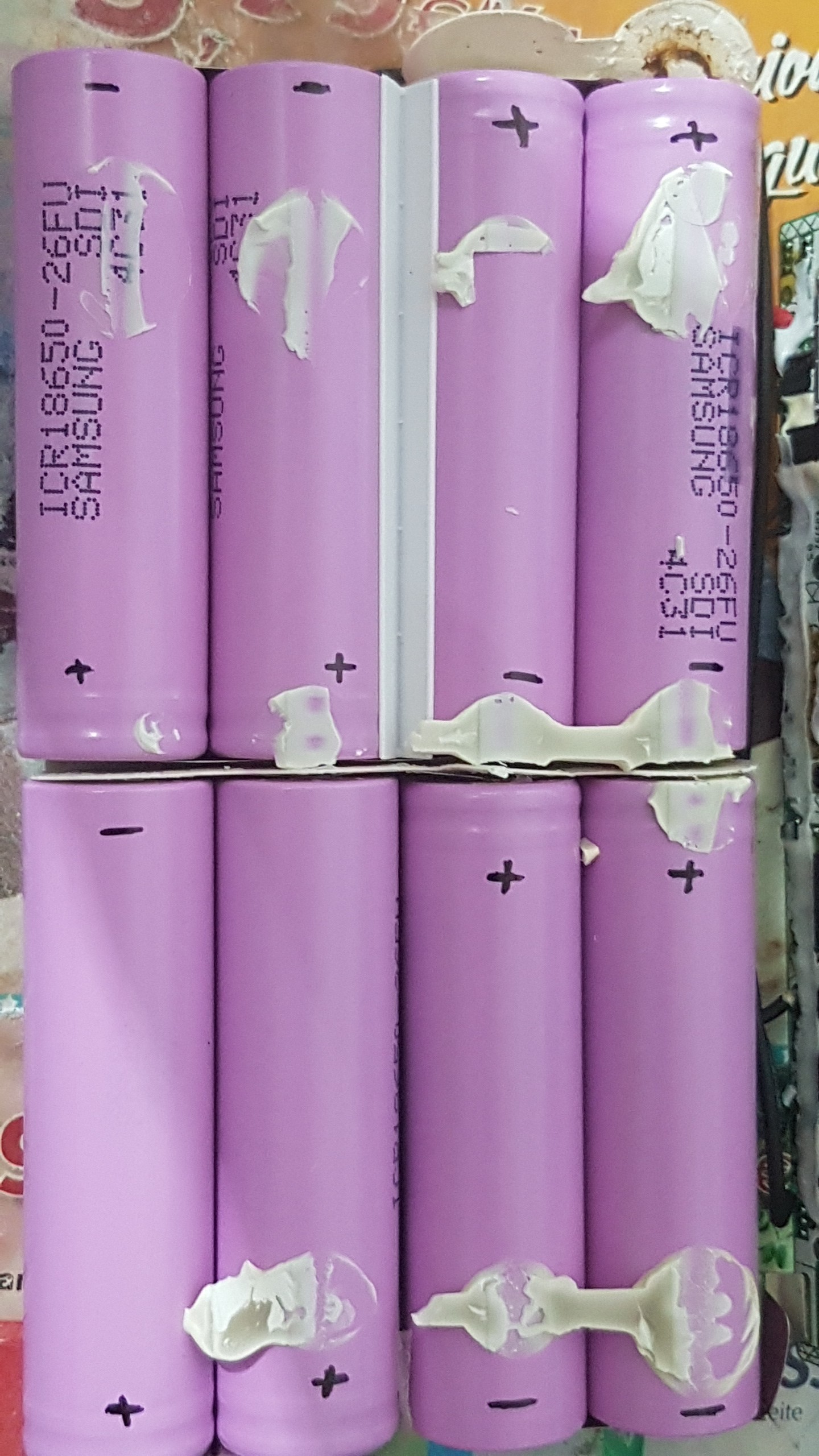

...OK , I can tell by that label it's a 4s2p battery (assuming it has 18650's inside and not prismatic) 18650s are like AA size but a bit bigger..
You have 8 of these cells inside , each with an original capacity of 2600mAHr , ...
To buy these cells new , Sony or Panasonic would be about $7 each , you could risk buying unbranded cells and halve that price , they may be OK .... Don't by ultrafire , truefire or any other flashy brand that says it has a capacity over 3500 when measured the capacity is close to 1000mAHrs .... No 18650 has been made with a capacity over 3500mAHrs ...If possible buy cells with tabs it will make soldering much easier.
So you have the option of using the battery as it is with 28% capacity ... breaking it open and trying to replace the cells , risky. even with the new cells it may not work , the pack or computer could contain a chip to prevent use of refurbished battery.

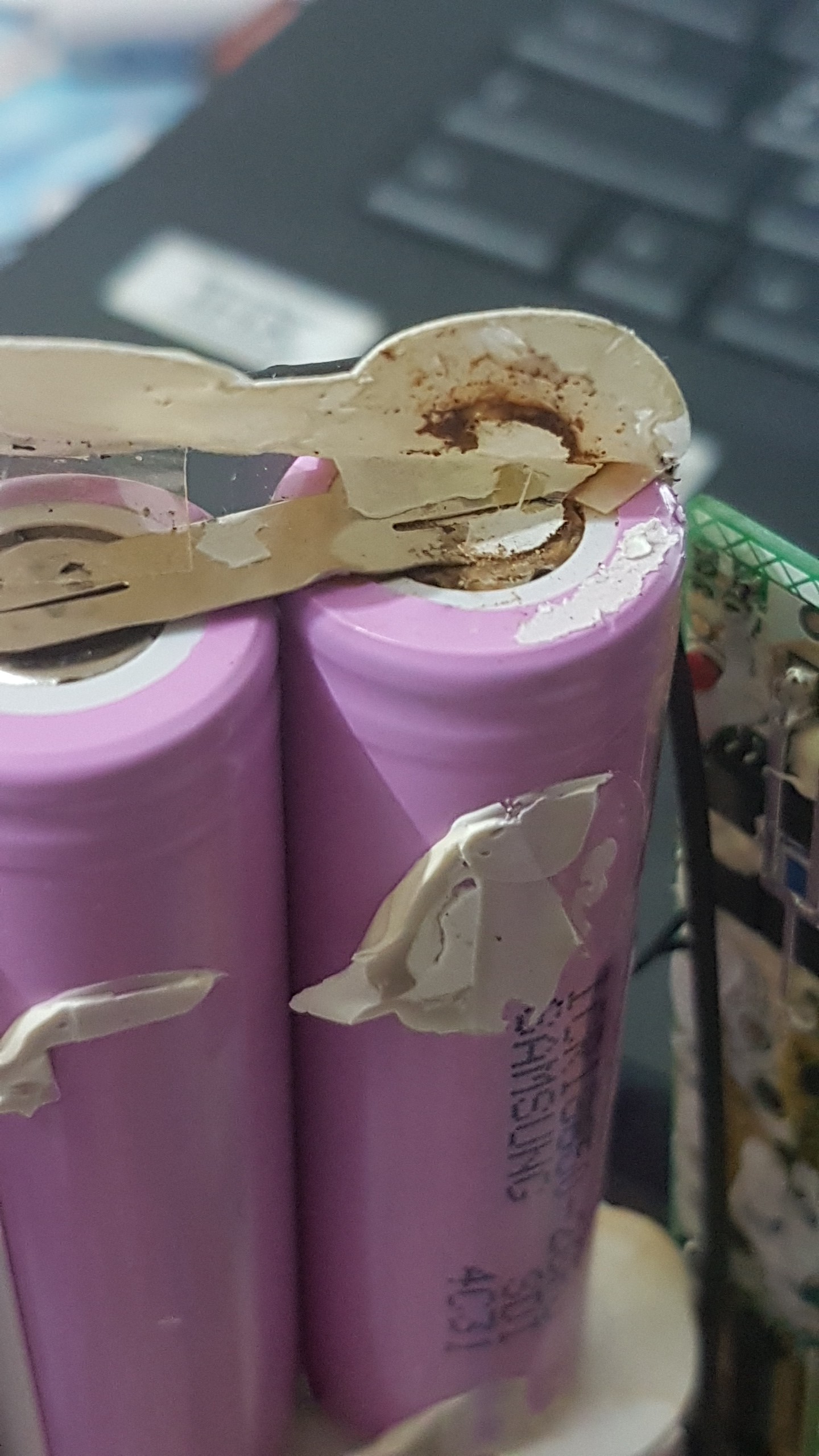

I think I have a culprit here. Check the picture below:
That one is the only cells showing signs of rust or leakage or whatever that is!
But as I think they are in parallel, 2 by 2, I can't measure that specific cell without completely detach it from it's pair!
I think these are 8 batteries, in parallel 2 by 2...

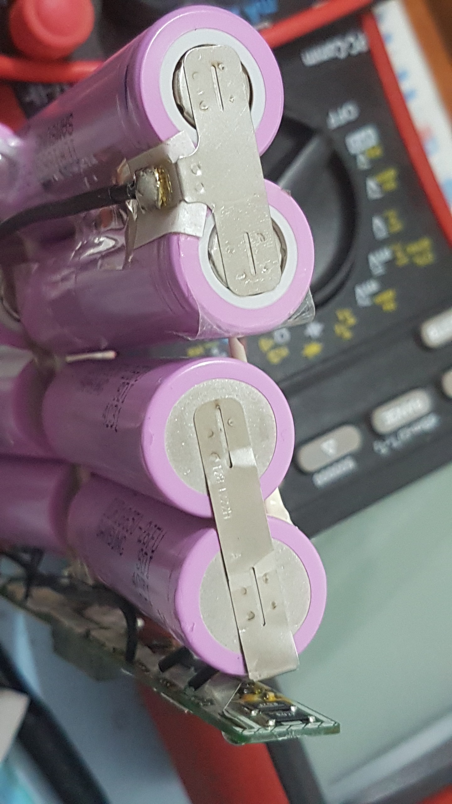

A few more pictures:

Yes ... often when I have a battery like that just two cells will be no good , the other 6 will usually be OK , but will be old and have reduced capacity ... you could replace just those two ... it might work for a year d before another 2 old cells pack up .... you may even be able to replace the two dead cells with one new one since the new cell will have double the capacity of two old ones ... try to get cells with tabs .

"e.g.," mean for example, not that is. In other words, one of many options to consider. Who knows, maybe those batteries will work. Are you sure they won't?
For sure LiFe will not work ... 4 in series make very close voltage to lead acid , so LiFe are perfect for replacing car battery ... 4 li-ion in series are 14.8V....
There's no need to complicate things they all cost the same ....
If I were doing this , and finances were tight , I'd just replace the two dead cells with One 18650 ,
This one is 8 Euros , it has a high capacity , so only one will have close to the capacity of two old cells ...
https://www.ebay.co.uk/sch/i.html?_...0.X18650+tabs+.TRS0&_nkw=18650+tabs+&_sacat=0
Really you should replace all eight they are cheaper for Eight , around 20 Euros unbranded

Does this assembly have 2 different negative "sides" (can't remember the correct name)? Or are they isolated?
