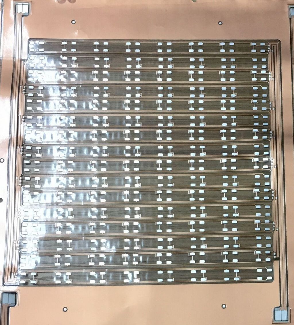

I haven't found much time to work on this recently, but I managed to make a few steps nevertheless. One of them was deciding to change the transparent flex PCB construction. The first design required to glue all flex PCBs onto acrylic base plates. It is almost impossible to do that without having bubbles inbetween. The next design will use a completely different approach. You can see this in the below picture.
I also used this opportunity to change to APA102-2020 LEDs, because they are much smaller and will drastically reduce the amount of obsticles in the light paths. Populated sample flex PCBs are ordered and should arrive in a few weeks.

I just got this picture from my PCB assembly service
Thanks for the update.
I've been planning to make some of these cubes and assembly has always been a showstopper. Interested in seeing how the finished product performs. I still don't see how an interconnect scheme that isn't close to 100% transparent can work.

it took me quite a few redesigns of the mechanical support framework for the flex PCBs in place, but it finally works now. A lot of thought had to go into finding a solution that would be as easy to assemble as possible, without the need of glue. This is how that looks like at the moment. I haven't lit up the new boards yet, but MultiCB is already making adapter boards. I'll be able to show the completed cube soon :)
