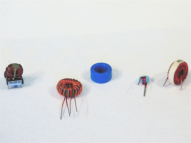

referring back to the circuit diagram, do you recommend me changing any of the transistors?
I will be using a solar panel that is about 2-2.4v and only 1 single 1300mAh rechargeable battery.
Thanks for the help :)

Bare wire is not used to make a transformer or an inductor. It will short the circuit. Instead the wire has an enamel coating as its insulation.
you said that bare wire can not be used to make these joule thief?
I got this from here:
http://www.evilmadscientist.com/2007/weekend-projects-with-bre-pettis-make-a-joule-thief/
but on some other pictures, I see that there is a plastic coating on. Im confused about this?
On the other hand, I will be ordering thses parts from ebay and I can get started with these :)
but I have encountered another problem. See my latest post about if I should use the transistors from the circuit diagram or the ones the person(from page one) recommended me?
Thanks in advanced.

I just found this!!!!! :)
http://www.maplin.co.uk/high-current-toroids-3631
thing is, it has only 1 wire but I do have a massive roll of wires(about 400 meters )[dont ask where i got it from... ]
I can take out that wire and replace it with two wires(with the plastic coating stuff on as well ) :)

All the wires in your photos of ferrite-core inductors have enamel insulation.
Transformers are also made with enamel insulated wires.
To connect to the wire then some enamel must be removed from the ends.
I "stole" some wire from an inductor in a 2-way speaker crossover network and it also had enamel insulation.
Sometimes the enamel insulation is very thin, that is why on some of the photos it looks like there is no coating but in fact they do have them but it is hard to tell :)
Going to order some toroids today :)
