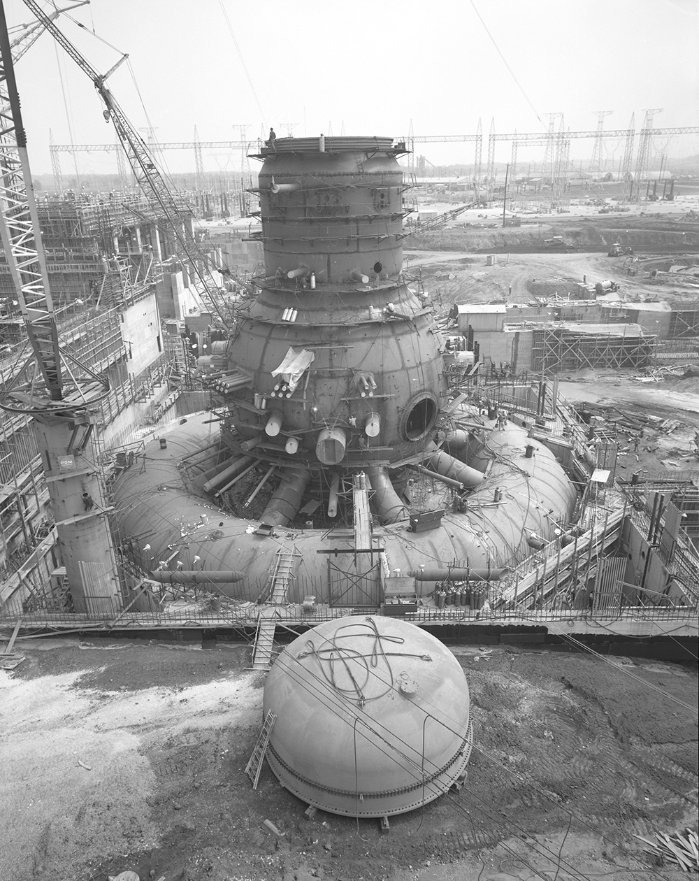

Found this image. This is a photo of a BWR being installed. The "upside down lightbulb" is the actual reactor chamber. The torus/donut at the base is the supression pool to keep pressures in check by converting steam back to water.
Around this lightbulb and torus are between 5 and 8 feet of pre-stressed, extremely reinforced concrete (2" rebar at 12" spacing in 4 areas throughout the 5-8' concrete containment. The outside is then again covered with 2" steel for biological shielding. This structure is then built out about 75 feet per side from the central pressure vessel, where the spent fuel pools are added. Control room is on "ground level", which is about even with where the pipes leading down to the torus are in this pre-contained image (from construction). This is to give you an idea of how much shielding there is, how reinforced it is, etc. The amount underneath the reactor makes the primary containment seem like origami.
This is what is sitting below ground level in the images from Japan. The spent fuel pool is at the same level as the "lid" in the picture, which is about 3 stories up from ground level, while the torus/donut is 2-3 stories below ground level.
The damage seen in Japan has been the "weather shield" on #1, which is somewhat strong, but meant to blow off to protect primary containment (think fuse). #3 and #4 suffered more severe explosions, where the 4th floor was damaged, leaving the rebar showing. The issues are the spent fuel pools on the 3rd floor in the "exposed" reactors, and in the torus/donut on the number 2 reactor. That is the latest very scientific guess by many experts, anyway.
Look at guy lower-center-left, standing on the torus, to get an idea of scale. Only about half of the reactor is "above ground".
