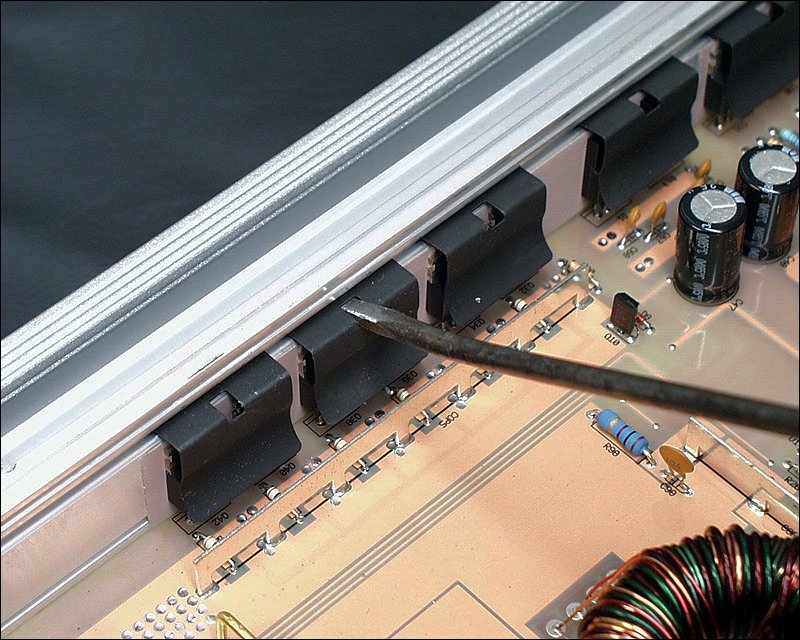

trying to make a 6 way mosfet switch, each mosfet working separately and independent.
Can I use just one piece of cooling plate for all of them? that means all mosfet's Drain hook up..

Often, with a group of FETs close together like that, a strip of silicone insulation is used between the FETs and the heatsink, then they are all clamped to the heatsink using a bar that is screwed down at each ens. The bar runs across the plastic body of the FETs.
Ur, special spring loaded clips are used...
Here you can see the strip of grey silicone insulation, and a screwdriver being used to remove a clip.
Google "TO220 Insulation" for many pictures.

actually, the point of my question is is it necessary to insulate the mosfet piece by piece?
Yes. All must be insulated from the heat sink and each other.
Unless, of course, you use FETs with isolated tabs.
Even if all the tabs are electrically connected together in the circuit, I'd advise insulating them anyway so there is no power on the heat sink. It can then be connected to the chassis.

In your post #4 circuit the FET is a low-side switch for the LED load. If you connect all 6 drains together you won't have independent low-side control of 6 loads.
