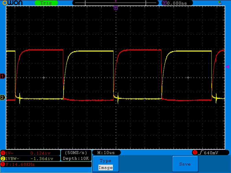

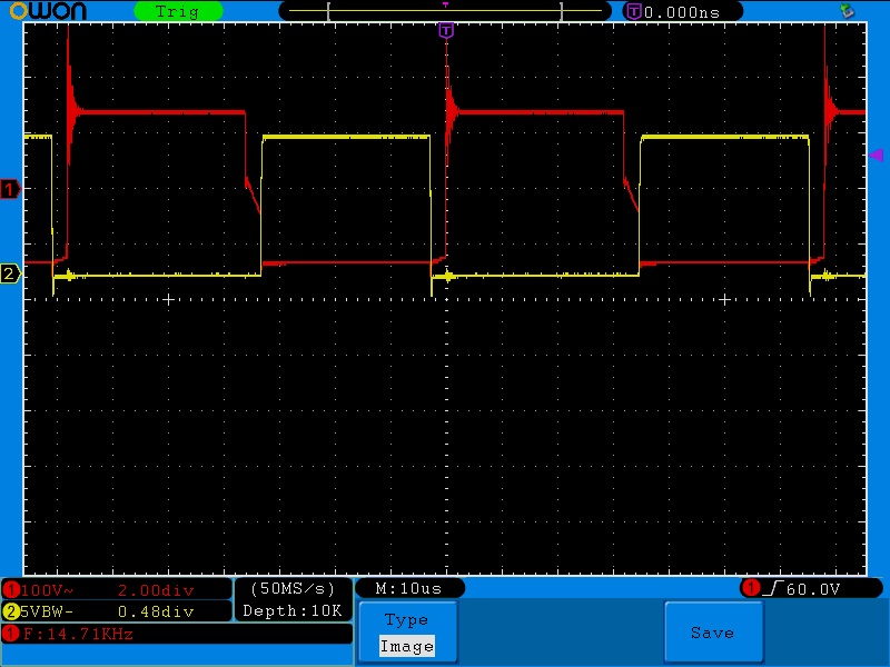

hi buddies...i want to drive irfz44 mosfet with ir2113 gate driver..for HIN and LIN input i used NOT GATE and schmitt trigger for create dead time but in output of HO.. my square wave have additional edge...below picture
this edge increase my losses...What is my mistake?...tnx

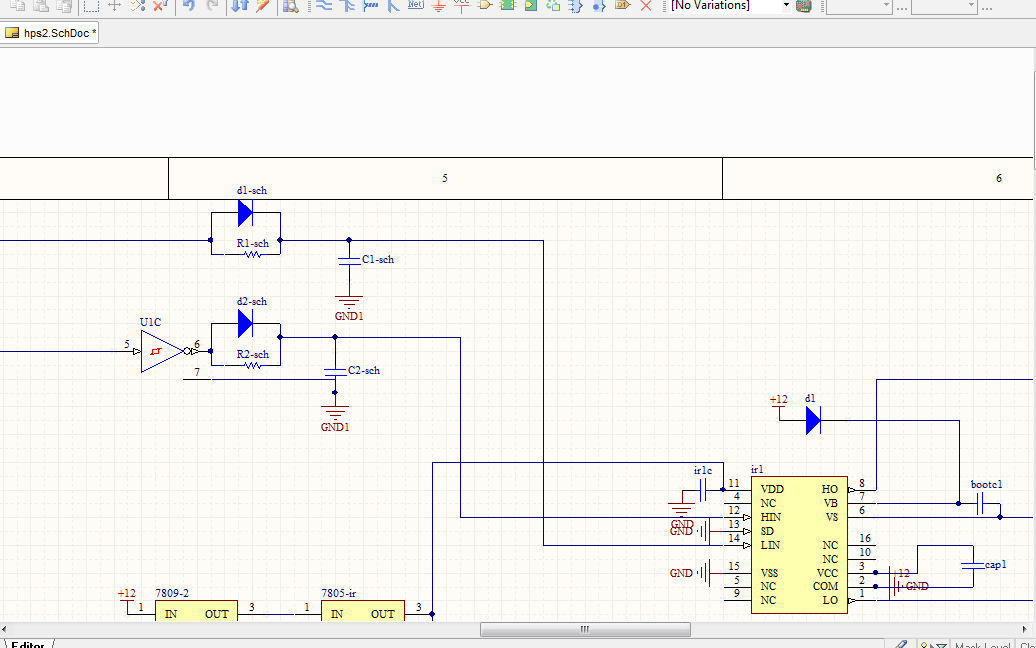

Without seeing a schematic of your complete circuit we can only guess what the mistake might be.
Alec_t
Joined Sep 17, 2013
15,147
What are the values of all the components shown?
What waveforms are driving D1 and U1c?
What gate resistors are you using?
tnx
input freq value is 15khz square wave with equel duty cycle......c1 and c2 value is 1nf.....R1 and R2 value is 2.2k ......U1 IS SN74HC14D..Hex Schmitt-Trigger Inverter
d1 ana d2 1n4148
FET gate resistor value is 8.2 ohm
U1c merely provides polarity inversion: it does not introduce any significant dead time.
Why are you using R1,C1,R2,C2? Normally you would want fast switching of the FET gates.
u1c introduce invert polarity wave for HIN input
R1 ,R2,C1,C2 to cause slope wave and when this wave crossing schmitt trigger it cause dead time....the rate of dead time depend on value of c1 and r1

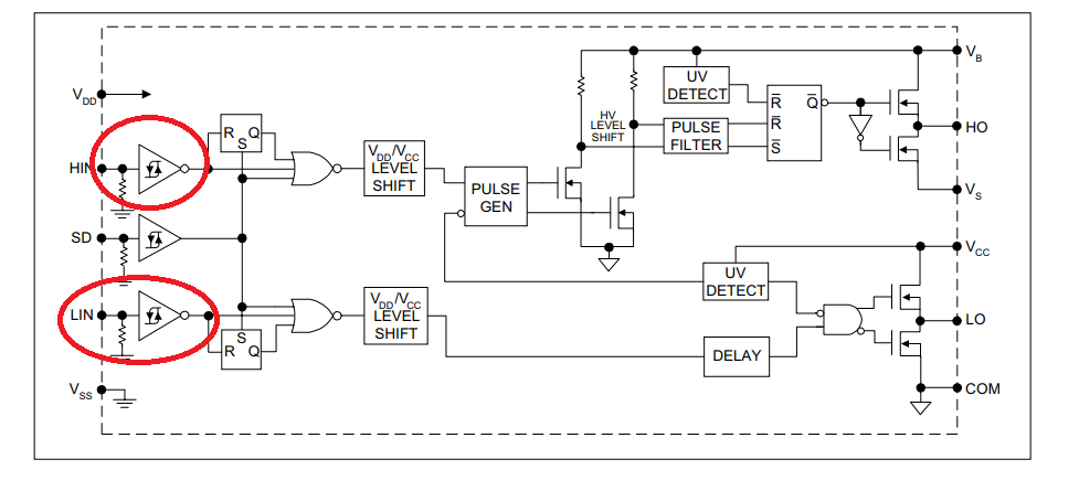

tnx..thats right...but according to data sheet the input of HIN AND LIN have schmitt trigger
my wave after crossing R1,R2,C1,C2
output of ir2113 HO AND LO

The first scope shot waveforms would need the polarities of diodes D1 and D2 to be reversed, compared to what is shown in post #3.
What loads are connected to the FETs being switched by HO and LO?
If I'm reading your scope shots correctly you have channel 1 AC-coupled, channel 2 DC-coupled, and both channels offset by different amounts from zero. Why? It makes waveform comparisons more difficult.
If channel 1 is 100V/div, HO peak-to-peak seems to be about 260V. Is that right? It is inconsistent with the schematic.
the first shot have power supply on mosfet but in second shot no supply on FET....i think that the problem in schmitt trigger of ir2113 ...i try to use external sch trigger
The FETs obviously can't switch on without a power supply. Unless the source pin of the high-side FET is being toggled high and low, the bootstrap capacitor won't raise the VB pin of the IC sufficiently to give reliable switching of the high-side FET. Perhaps that accounts for the problem you are experiencing. You can expect a step in the HO waveform, as a consequence of the dead time and the bootstrap operation.
Edit:
Here's a sim showing the step :-
