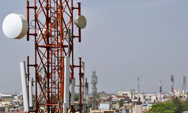

i have this type of networking idea in road side where there is telecommunication company boxes..
The "protectors" can't be 16 V. The ring signal is about 100 VAC.
I GHz is too high for wires. It's probably around 1-2 MHz.
The box you show basically looks like a demark point for a large building/apartment complex.
The "alarm" switch is usually called "Tamper".
Wifi from a tower: Google WIMAX. It may be used in large metropolitan areas.
