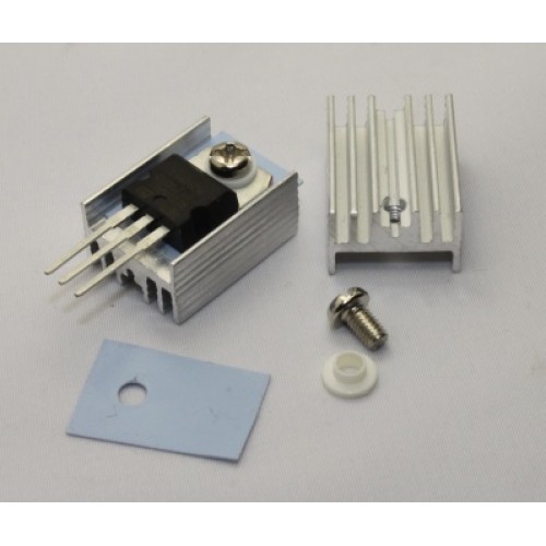

Thanks again for the info.
Here was my attempt at it:
I am planning on using the TIP102 with one of these heatsinks:
Do I still need an 8 ohm (5W) resistor directly before the TIP102 to protect it from momentary shorts if I have the diodes configured this way for protection? Thanks again!

The diodes only help if you connect it backwards. I think it is a good idea to add a small value resistor to take some of the heat from the transistor and minimize the damage if you have point-to-point wiring supplying power to something like a motor or speaker.

Ok cool, I will put that in then. So I think this should do the trick!

A 3.3, 4.7 or 5 ohm would be better (in that order as fat as I'm concerned). The darlington transistor will drop a minimum of 1 volt, so your 15 V supply is down to 14. 8 ohms from your fixed resistor and an 8 ohm load mean you only get (14V/16 ohms) of current through the load.
