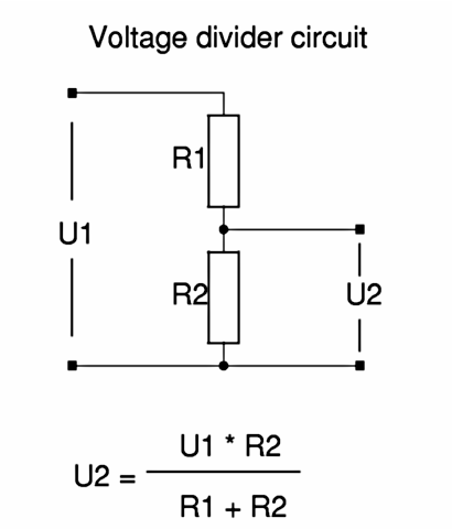

Ok, I think I figured it out, I also have the wiring schematic etc... so that helped.
They call this an amplifier board.
AIR4 and AIR1 form a voltage divider circuit, like a potentiometer.
NTE199 turns on about 0.4 or 0.5 volts
So depending on what the values of those two resistors, I can adjust the voltage the transistor base sees.
http://electronics.stackexchange.com/questions/127525/reducing-voltage-with-resistors
I randomly calculated that with 2.0volts coming in you want 0.4 volts going out.
So i picked R1 as 100 ohms, and R2 as 25 ohms, just arbitrarily to give the voltage drop.
What I have to do is measure the resistors ohms they used and go from there.
I dont suppose it matters much which resistor I change, but I think maybe R2 is better.

I dont suppose there is much current here, so maybe I could substitute a potentiometer for R2 (AIR1) and dial it in.
I suppose the electrolytic AIC1 keeps the transistor from pulsing on and off, pushes back like a battery, cause it looks like they rectify T1 sense coil and it is pulsing DC.
