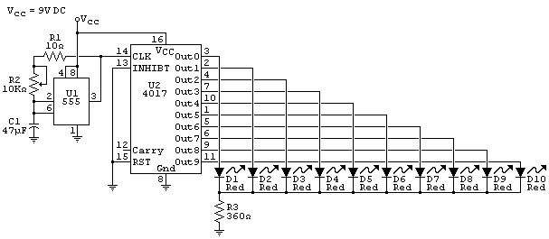

So I am new to this forum, and a little new to electronics. What I am trying to make or find is a 12 volt sequencial led driver that can drive at the most 10 LED's. I'm having a hard time finding one that states 12 volts most are 9 volts. I will be running it on a vehicle. Trying to keep the cost of it down as much as possible. If I have to get it in pieces that is ok. If anyone can help I would gladly appreciate it.

Can you expand on "Sequential" a bit more, do you want to make a multi led chaser, flasher, single led chaser,.?
Try the Cd4017 chip.

The circuit is bad even with a 9V supply because with a single current-limiting resistor R3 the LEDs that are turned off get reverse voltage much higher than their maximum allowed 5V. Each LED should have its own current-limiting resistor that are about 360 ohms for 3.2V blue or white LEDs. Use 560 ohms for 2V red LEDs.
The Texas Instruments datasheet for the CD4017 shows that its typical output current with a 14V supply is 26mA which will destroy it because each output transistor overheats over 100mW.

Use the same circuit but instead of LEDs connect the outputs to the base of ten MPSA13 transistors, and then use the collectors to pull down your load devices. That will allow up to at least 100Ma for each one light. The circuit as shown, or very similar, is shown in the "freeinformationsociety" website, along with a few thousands of other circuits.

If you need more current than the few mA a CD4017 can source, you can add transistors to drive the LEDs low side. Or you could use ULN200x darlingtons for ease of wiring.

So basically I want to make 10 led light light up one at a time until they all light up then do it over again.
Why didn't you say that in the first post? Something like this gets you most of the way there.
If you need more current than the shift registers can provide, you can add PNP transistors or P channel MOSFETs to drive the LEDs high side.

They would blink in sequence ( they will all stay lit until last one then start over. 1-10 then back to just 1-10 again.
The circuit in post #8 gets you mostly there. You just need to add a reset after the 10th LED turns on. That means using the QC output from the third shift register to reset all of the shift registers. You should also tweak the existing reset to give you a power on reset.
The reset pin on the 555 timer would be used to control when the LEDs sequenced.
