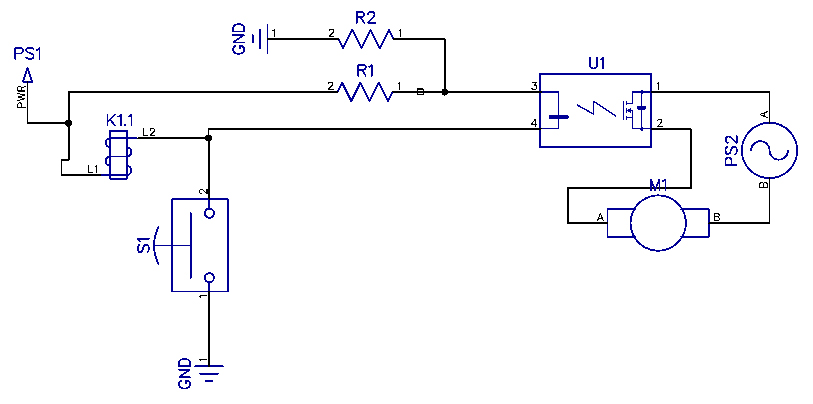

and to note, the 120Vac that comes out of the 30A relay into the 10A relay common and out to the "Hi Fan", the "Hi Fan" terminal is on the NC pin of the 10A relay. so in this case the board didnt even switch on in the coil of small relay...... i dont have actual schematic but once i get the replacement relays i can stick my fluke on the various points to see how it works.
i ordered the Omron SSR with heatsink. my plan to integrate it looks like this, let me know if you see an issue here (should i fuse the 120Vac at the SSR, or just rely on the 20A type TL i have in the disconnect?). i am splitting the V because the relay says 24Vdc (not yet sure what the real V is applied from the board) and the SSR is 5-24Vdc, so a split should be just fine, and as-is it acts as a pull-down on the SSR, etc:

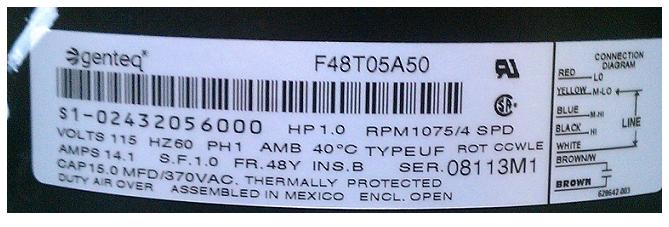

post #28 - i guess the real unknown for me is, should a 1HP 120v 60Hz motor be running at 14.1A, which matches the "Amps" rating that is on the nameplate? if it were running ~6A over what it should run at, i would expect that extra 6A to overheat the unit....
scary i am having to 'up' the wiring and relay for this motor when the motor wiring is just 18awg.

Drawing 14 amps give or take a bit on a 14 amp rated motor running at what is likely near its designed mechanical load range seems pretty normal and quite acceptable to me.

Now as far as replacing a mechanical relay with a solid state one for a larger electric motor load I personally would not. Due to the high inrush currents when they start its very easy to overload a SSR and kill it or have it short to full on where the motor will never turn off. I've seen too many people try using SSR's on electric motors only to have them fail due to the inrush currents being way past what the motors running amp values are.
If it was me I would just remove the 10 amp relay and rewire things with a good heavy duty 20 or 30 amp mechanical one.
I agree with TCM. Use a Definate purpose contactor. 24 VAC coil ones are very common in HVAC and last a LONG TIME.
The SCR/triac gets to turn on/off at least 2x each cycle. One at the zero current cross and one at the voltage cross.
It's complex to handle an inductive load using triacs and AC voltages. Where I worked, we used $600 SCR units to operate the primary of a transformer until I said enough with this. Let's use a DC power supply and we'll get lots of benefits. It was a low voltage high temperature heating application, Copper probably had the highest melting point of the materials we had to melt.

ok, so you think the Omron SSR i listed will not handle the load of this motor?
it's inrush rated at 440 A (60 Hz, 1 cycle)
data sheet here http://www.mouser.com/ds/2/307/g3na_ds_csm165-47293.pdf
the inrush that i measured using a General Tools clamp meter was 30amps, the Omron SSR is rated 40amps.
the board uses low-side switching of the relay coils. this means the schematic i posted a few posts back would have the +dc voltage on both + and - pins of SSR at same time (slightly less on + side due to diode there), i'll need to add a PNP zistor in there to turn on/off +V to the SSR.
in this pic of motor wiring, what does the wiring mean? the control board used black for "Hi Cool" and the blue for "Heat". does this mean the heat cycle runs the motor at some other speed "M-Hi"? if so why? is "Hi" too fast for the heater? should AC cycle also be on the "M-Hi" speed? i suspect dwell times of air in the heater and AC expander coils are different? would slowing the air for AC mean the air would be colder? also, the "Heat" terminal on board is on the NO side of the smaller 10A relay (NO is heat cycle, NC is the cool cycle). this unit operates in very dry climate (12-17% RH most of the year, then 2 months of on/off monsoon rains). should i just run this thing on M-Hi for both heat and cooling?

You ave 4 speeds AVAIALABLE High,medium high, low, medium low.
In general, a high speed would be selected for cooling and a low speed for heating. Multi-stage furnaces can make use of the high speed speed for heating when there is a large difference in intake and exit temps.

here's my schematic for SSR switch, will run the unit on hi speed for both heating and cooling for now.
K1 is the existing 10A relay, and S1 is on a pin of a dip IC, from what i see, low side switching of the relay coil. the AC side has 20A type TL fuse as well as main panel 20A OCD.

you mean allow the SSR "-" to sit at +V (off state) so there is zero diff between them? i would need to use voltage divider on the + side of the SSR, so it would be say +11v on + side and 22v on the - side of the SSR while it was off. when the dip goes low the - side of SSR would fall to gnd. no issue for opto? spec sheet doesnt indicate opto reverse voltage specs. its a diode of some sort, i cant imagine 11vdc being an issue for the diode.
