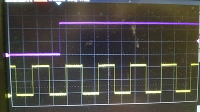

Here we see the debug traces of two interrupts on a PIC Q43 controller. The top line is a process interrupt low priority ISR (low to high trace means processing starts) that processes ADC data from a 10 data point buffer into voltage, current, power and energy floating point numbers precisely every second for battery coulomb counting. This takes about 10ms of processor time every second. The bottom trace is the ADC conversion complete event high priority interrupt ISR that toggles a debug pin. The actual ADC processing time per interrupt is at most a few microseconds. You should notice there is no change in the speed of the high priority interrupt while the low priority interrupt is running.
