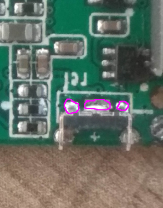

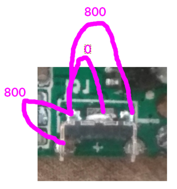

How to repair or replace this micro switch please?

OK, if you were in the US I was going to offer to swap it for you. Remove the battery, put your multi-meter in continuity mode (beeps when probes touched together) and figure out which of those metal pads where the black button USED to be connect to which pins on the button. That will tell you which pins you need to connect your new button to.

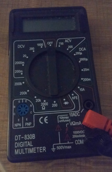

I don't know if I have the continuity mode on my ohmeter it's a very basic one, can I do it in another way ?
MrSoftware
Joined Oct 29, 2013
2,279
The diode test feature should work, see if it beeps when you touch the probes together. Also the 200 ohm setting will also work, but you will need to look at the screen. I circled both in yellow:

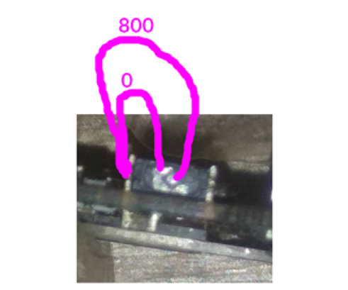

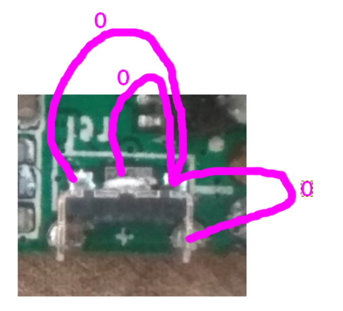

Here are the measures I did (I used the diode selector) and here are the values shown by the screen ::
- I tested the first green pin with all the others:
- I tested the 2nd green pin with all the others
- I tested the metallic circle and edges inside the switch :
I hope I didn't mess with the multimeter tips because there isn't much place. I can do it again if the values are not logical if needed. Thanks !

You should have three connection on the switch a C (COM)mon as well as NC and NO.
you either switch from C to normally open or C to a normally closed.

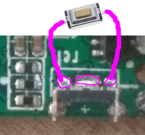

I found a tactile microswitch that looks like the one that was on the pcb, do you think Ican I solder it like this ?
